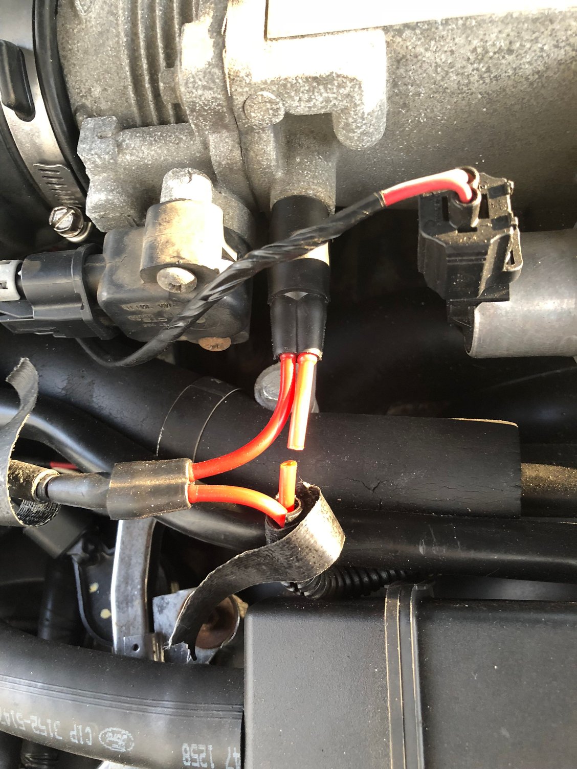

does anybody know where I can buy a new one of these red hose mine broke I cant find one I know its a vacuum line if anybody could help me that would great thanks.

Doesn't need to be red, just the same size vacuum line.
Any local AutoZone or Advance Auto should have it.

you can pull the broken end from that rubber nipple, then just reinsert whats left on there into that rubber, or get a small piece of rubber vacuum line thats the proper diameter and make a connector to hook the 2 broken ends back together. no need to replace the entire line
