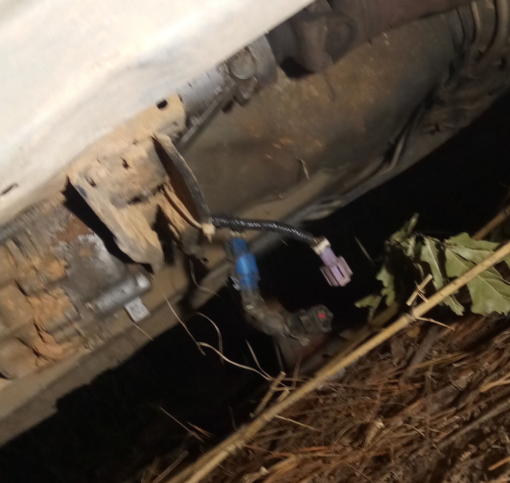

Got a 2002 GT that was repossessed from the Bank. The exhaust was missing. Enclosed is a pict. of wiring at the rear of the transmission.
Is this for the (2) rear O2 sensors?. If so then which color or connector is for the right & left. If it matters.
Thanks for the help.

plug one sensor in, clear the codes, then turn the key on a few times and see what code comes back. that will tell you which side it is supposed to be on

Or you could just hook the blue to driver and purple to passenger (the correct orientation by the way) if you dont like to experiment first lol
