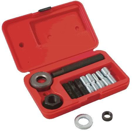

I got this one for under $15 from Harbor Freight.

Bruce, I bought that same installer from Harbor freight. However, none of the threaded pieces in the kit are the same diameter as the new crank pulley bolt that I bought from Ford. It looks like that is a puller for alternators and water pumps, but doesn't look like it will fit the crank pulley. Have you used this kit with success on the crank pulley?

That looks like small puller of some kind to me too. The Harbor catalog does not show a balancer installer, the last time I looked.

Just bought it on Friday. It is a pulley puller and installer kit for accesory pulleys. I'm waiting for some 8 rib pulleys and an overdrive damper to arrive. I was hoping to be able to use it for the damper also. More than likely I'll use a long bolt to pull the damper on. There are a few fastener stores nearby that carry a wide variety of bolts.

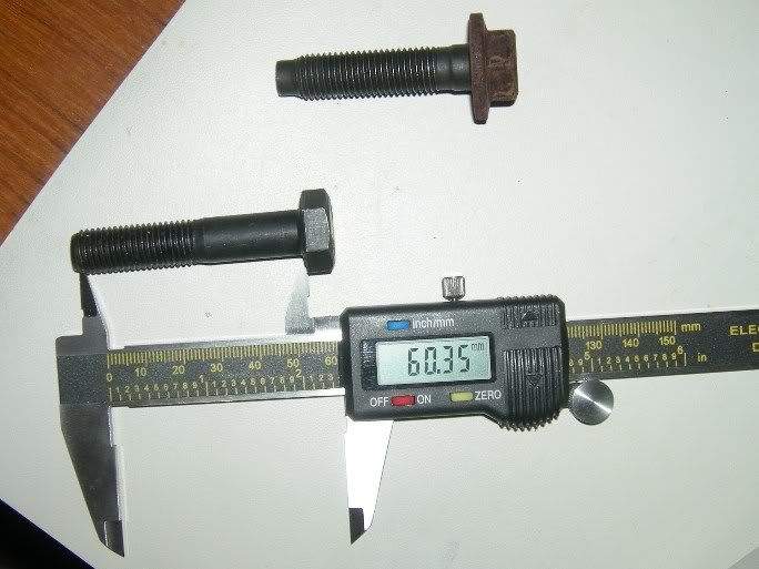

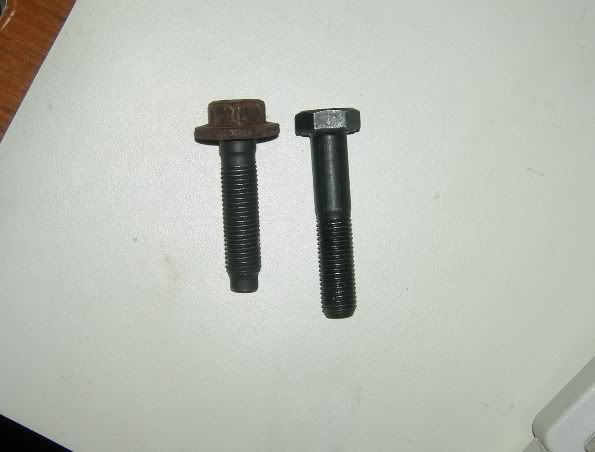

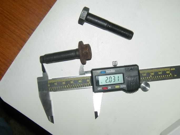

Where do you live? I have an unused Steeda bolt, but as suggested it might be simplier to get one at lowes etc than to pay postage to get this one.
(I will go measure my Steeda bolt length and edit this post...BRB)
EDIT:
Steeda Bolt = 2 3/8" or 60 mm
Stock Ford bolt = 2" or 51.5mm
Side by side
