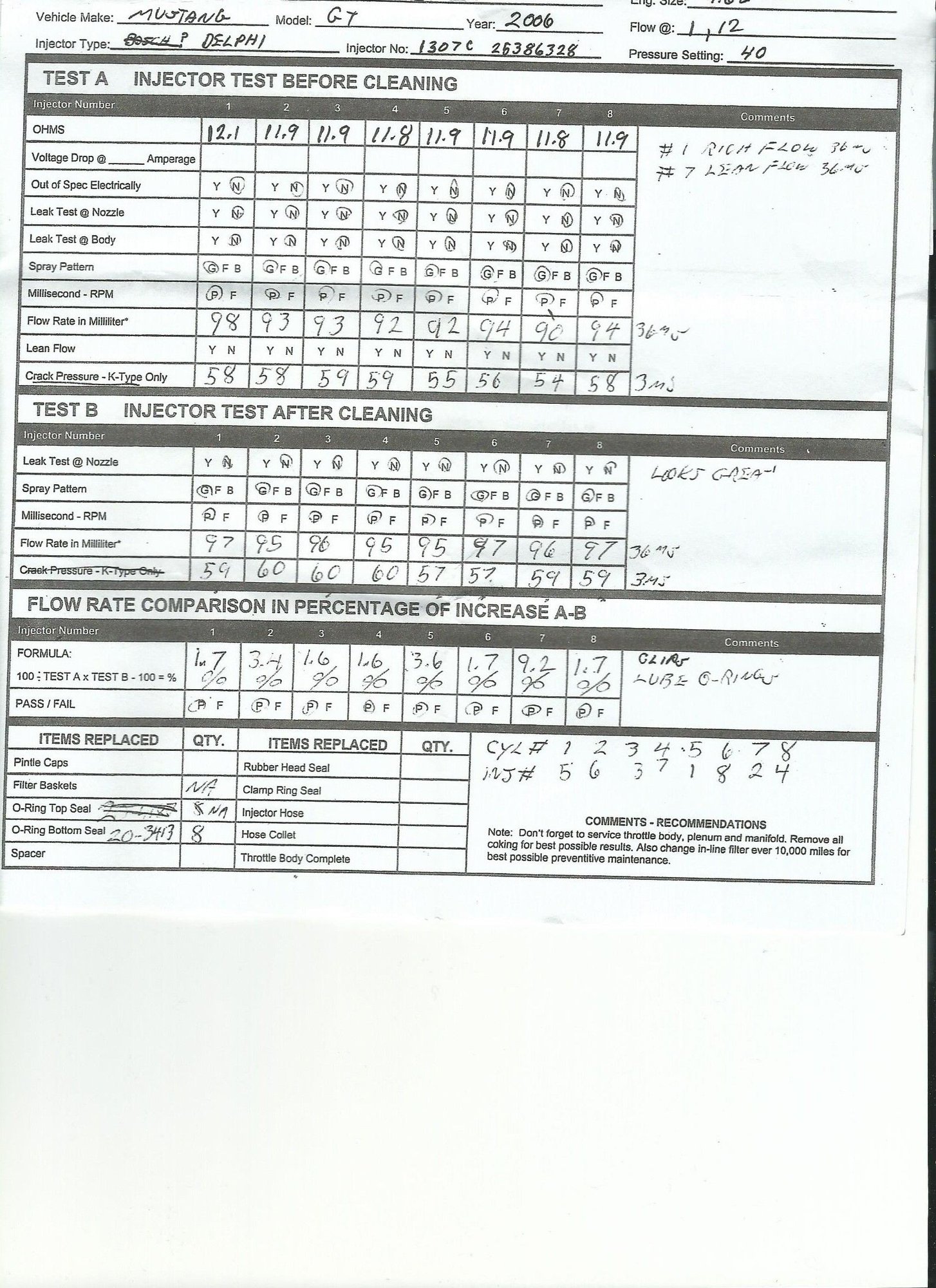

The car will lean stumble only when hot and only after startup. the stumble will last approx 8 seconds and correct itself but sometimes kicks the code P0171 and P0174 for lean left & right banks.
I have changed the MAF, Fuel Pump, and recently broke down and took it to a shop where he diagnosed it for 2 hours and determined it needed injectors cleaned which I had professionally cleaned.
None of this changed anything but made me broke.
I can share the snap shot of the data when the code is kicked and can share the live data if anyone might be able to shed some light.
I called the tech back who did the diagnostic and told him the injectors made no change. He said that all he could think was that the flash Roush did to the PCM when I installed it on 09 might have gotten a glitch.
I called Roush and asked them about a reflash and they said they will do it for $100, but almost never need to do that.
All I can think is like the guy said about the PCM, or possible vapor lock but the fuel pressure is like 39# when the error kicks.
I did notice quite alot of vapor pressure in the fuel rail when I was disconnecting it to remove the injectors for cleaning. When I disconned the quick-disconnect, I capped the fuel rail side with my finger and was surprised it had vapor pressure rather than fuel squirting out for the most part. It was like letting the air out of a tire for about 5 seconds.

If there are sharp diagnostic techs on this forum I would appreciate any consideration. I have the freeze frame of the error code P0171 I can post with all of the trims and 02 data, and I have 2 diagnostic printouts from the tech of the continual rise of fuel trim at idle warmup and also at 3000 rpm if anyone might be helpful and give me an opinion based on the data.
As regarding the ultrasonic cleaning of the injectors, they were professionally cleaned
. Here is a printout of the pre cleaned performance of the injectors, and after cleaning and fine tuning.
Thanks,
John
