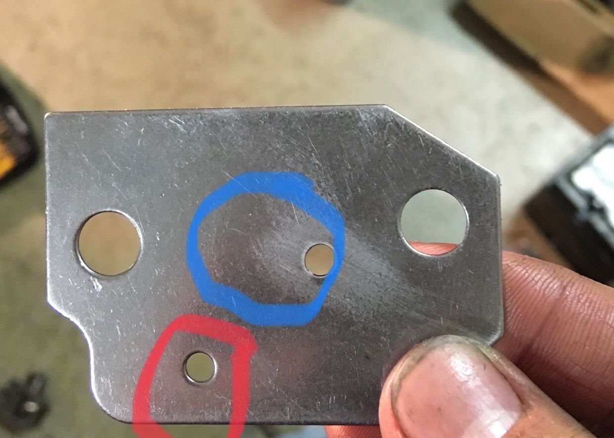

Hi just wanted to give you a huge thanks for helping me brain storm, I searched some more forums after finally getting around to looking at my car and realizing that sound was coming from right behind the timing cover. I came to the conclusion that what I was hearing was my chain with some slack in it, I took everything apart and sure enough my upgraded tensioners had spacer plates with the hole in the wrong spot, I found someone on a f150 forum who had the same problem with the same tensioners, they just got rid of the spacers completely and bolted the tensioners straight on which is what I am doing now I'll post a pic of what the spacer plate looks like and where the hole should've been, I'll give another progress report once I have it back together

Blue is where the oil feed hole on the engine lines up and red is the original hole that was on the spacer, I removed both of my tensioners and neither were getting any oil, I feel pretty dumb for not putting it together in my mind the first time that those hole locations weren't gonna work
