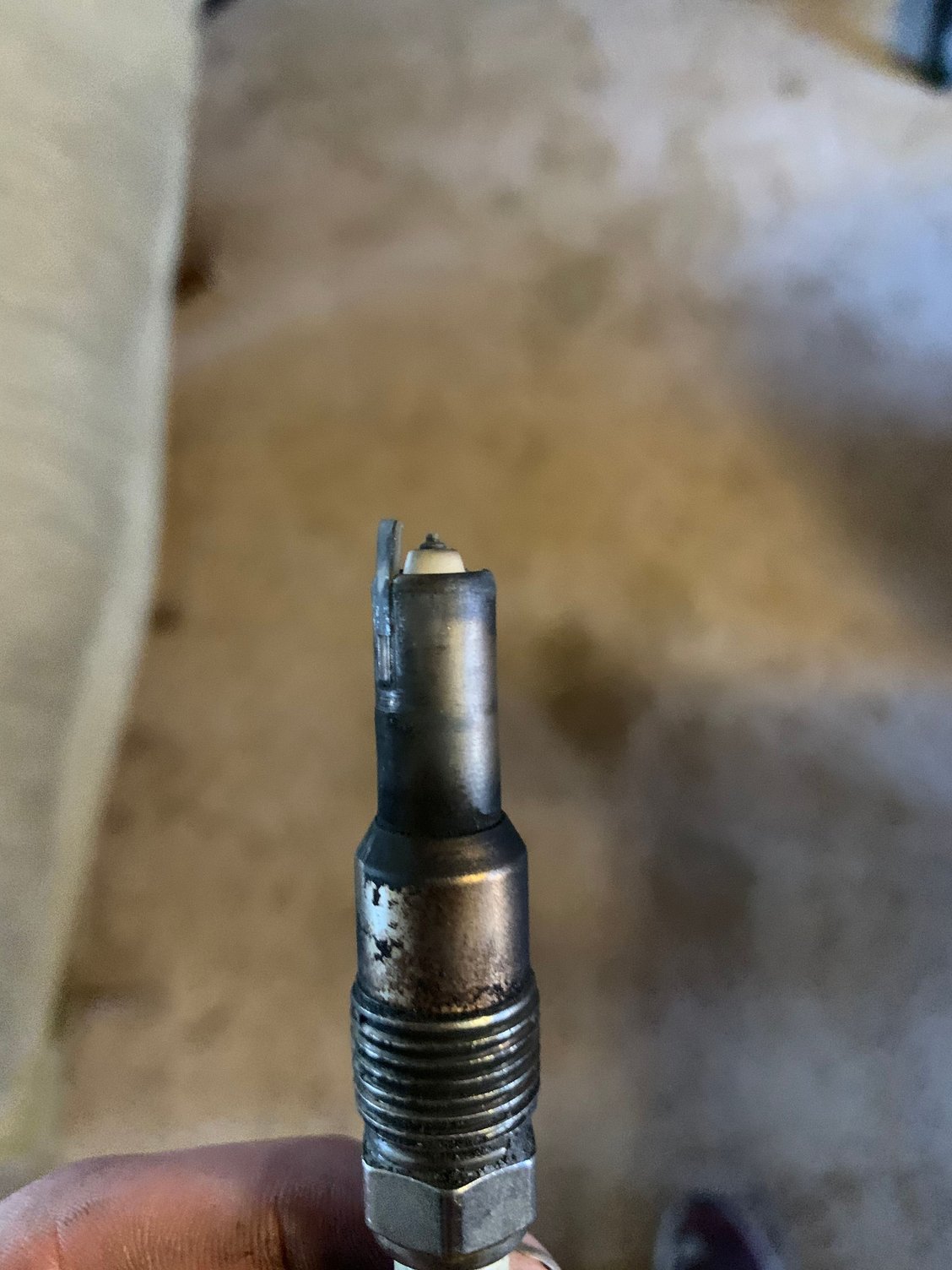

i found the problem I had 5 spark plugs that the ends broke off of and where causing the misfire

Mmm..you sure the plugs didn't break when you tried to take them out to check them?
Did you already replace them and confirmed it fixed the problem? If so, I'm wondering how they broke in the first place? They don't just break unless someone tried to remove them and left them as they were and didn't tell you about it.

I found the problem it blow the tips off of 6 out of 8 of the plus talked to the parts store and they said it is normal with the motorcraft plugs replaced them and has not had a problem for three months know it is acting up again any recommends on god set of plugs
