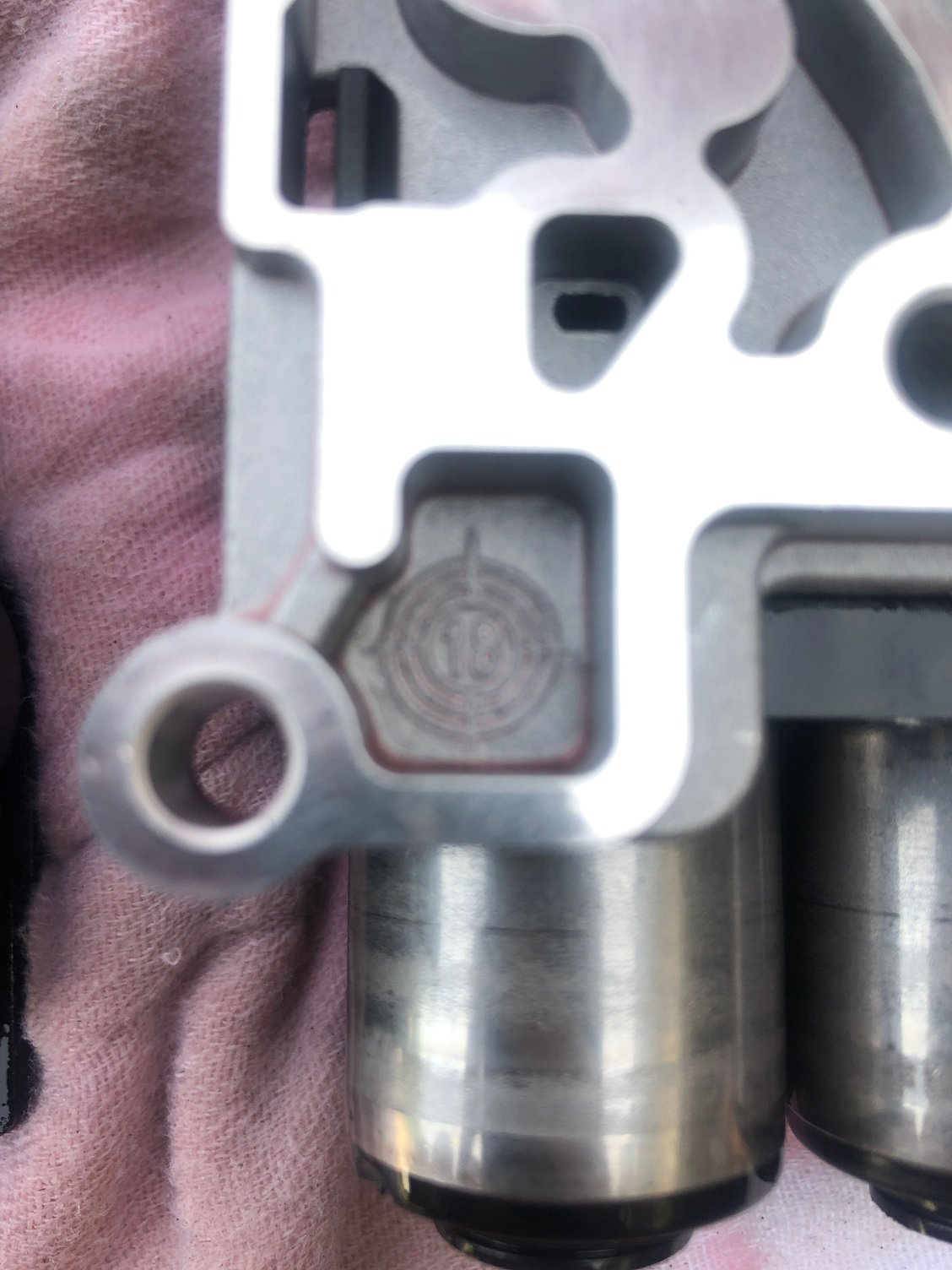

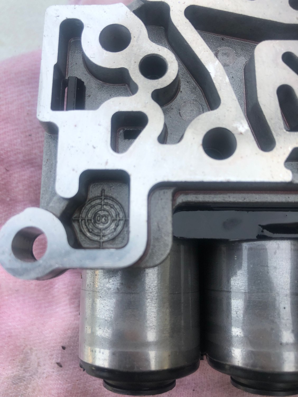

I’ve done the correct fluid refill procedure and made sure it’s Mercon v as well. I’m going to check the connection later today and see if I find any issues, if not I ordered a replacement off of rock auto and hopefully the solenoid is the culprit like I believe it to be. But no it does not have exposed wires however I did buy it for around $160 so I doubt it is a quality product.
$160? Cheapest I see on their is $200
The only brand Rock Auto carries for this item that i MIGHT consider in a pinch is the Standard Motor Products brand. That's $250 though. You can get a Bosch for that price or less.

Ahh okay, yep Wit was a rebuild then for sure. I've never seen any packs last too long on modern cars from any supplier that rebuilds them. not just Wit.
Let me know how it goes with the Standard part install and resolution of your problems.

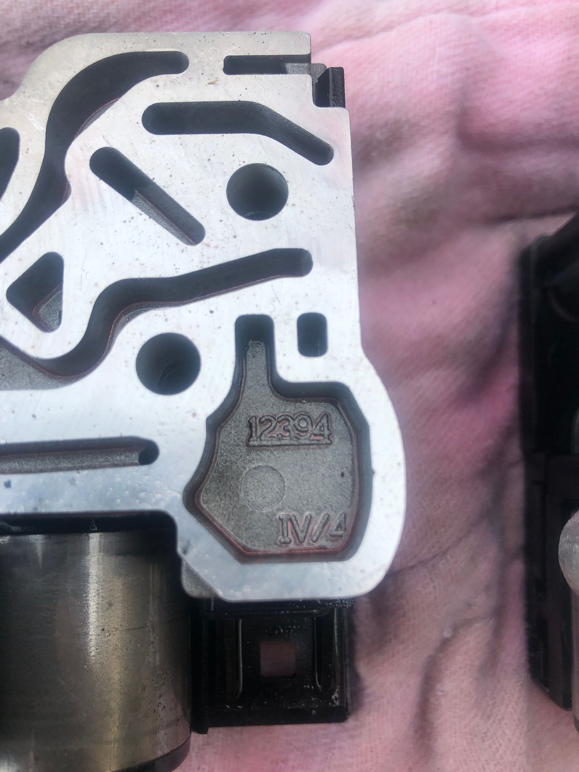

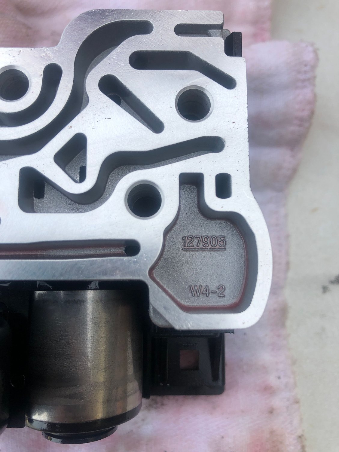

The slight variation in number doesn’t matter. The difference could be a supplier designation or a batch ID for the casting, etc.

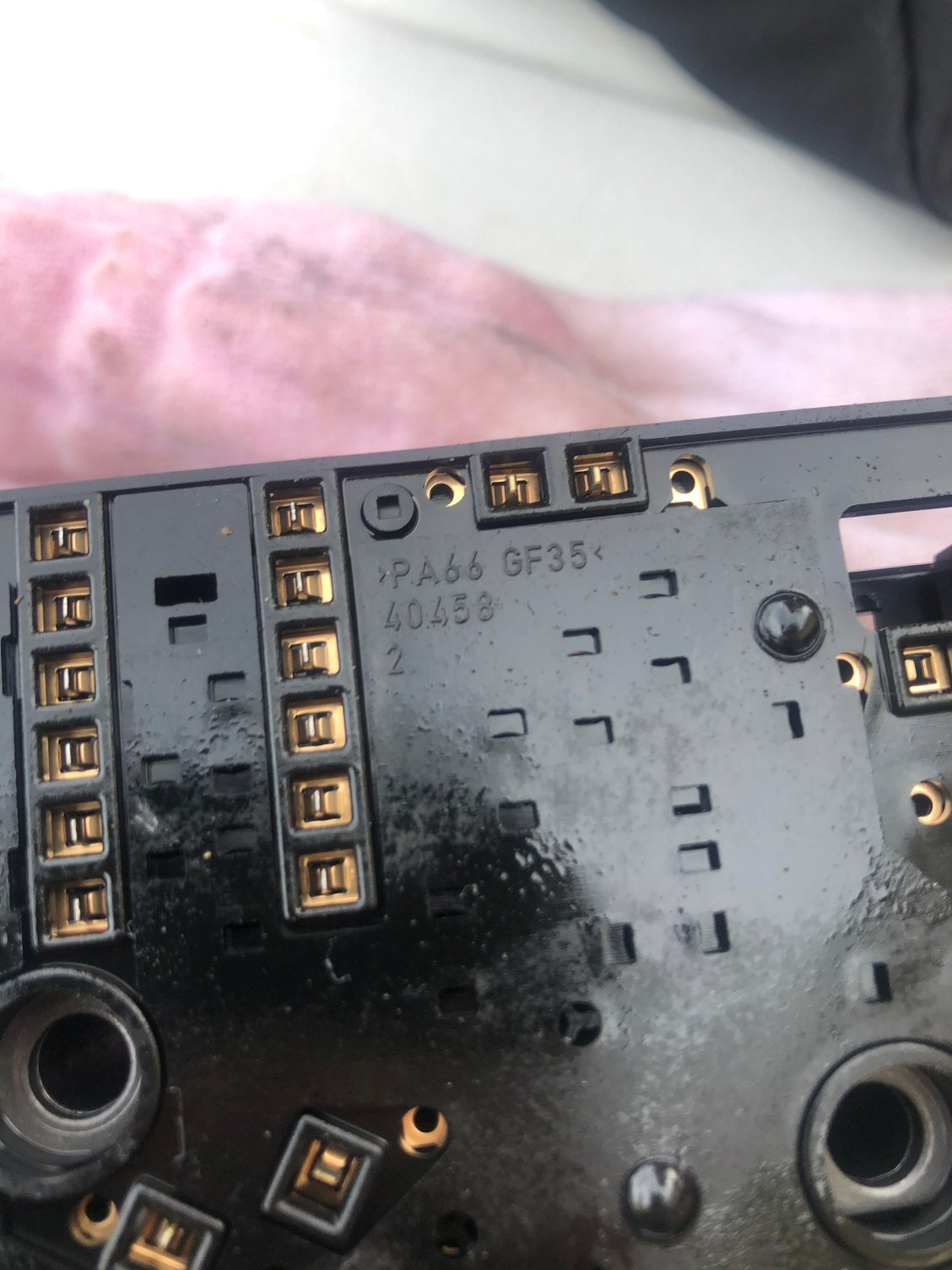

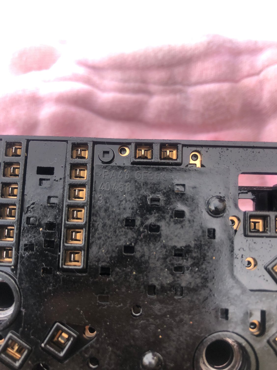

The OBDll codes you got are directly related to electrical issues, not mechanical ones. That points to solenoid failure or circuit board problems provided you ruled out the harness and connector already.
Good to hear it’s running good right now. Heat is the primary cause of failure for solenoid packs so, if it goes well for a while then fails again, it’s the brand. I know you don’t want to their that and I hope it doesn’t fail on you, just be aware. Standard (brand) at least is good for electronic ignition components so they do know a thing or two about....electronics and heat.
