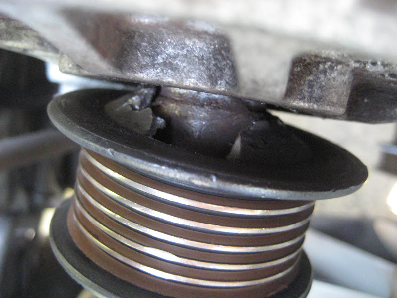

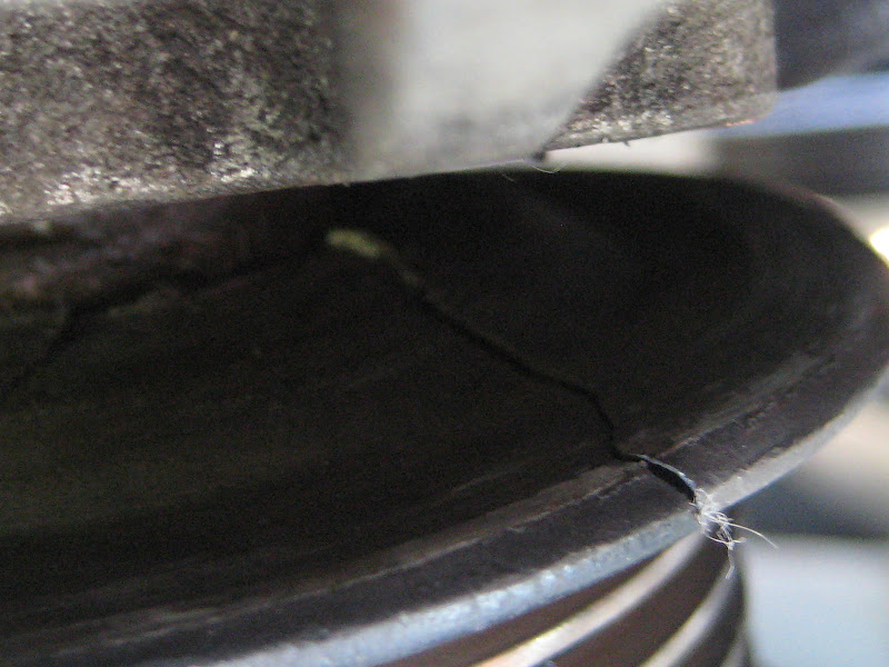

Anyway, when I popped to hood to take a look, I found that the alternator pulley had basically torn itself apart - it seemed to be a cast aluminum pulley, and fell apart into chunks when I touched it. The reason everything else stopped is because I threw the drive belt. The pulley is completely sheared off from the alternator shaft, with a large chunk of it missing and a crack that propagated all the way out to the rim of the pulley. Could a hard shift have caused such a catastrophic failure?

I'm adding some pics of the destroyed pulley. It seems like the Ford Racing 90-amp alternator is still good. The spindle still turns and as far as I can tell the fan and rotor are still spinning freely inside. I'll probably have it tested and maybe keep it as a spare if it's ok. I'm wondering if there was too much tension on the belt before, causing the pulley to shatter...

I would think the belt would slip before transmitting enough force to destroy the alternator pulley. Besides, you don't hear about people dumping the clutch at 5000 rpms at the dragstrip and breaking pulleys.
May have been a poorly crafted pulley. May have been damaged somehow by previous owner.
