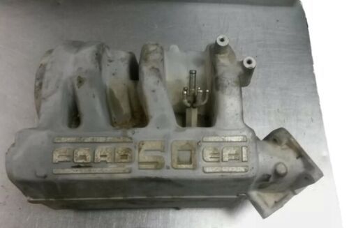

Ive got this Holley systemax2 lower intake look-a-like (efi) but it has a Ford logal in the casting with a Ford part number RF-E9TE-9K461-A4A. What is this? Any history would be appreciated. Ports are the same as the systemax 2 lower ect.....

some 302 trucks had those lowers on them..

Yea it is a truck lower. Saleen and Vortech stole the lower to run on there upper years ago then Holly stole it from Saleen and Vortech.

Illbe dam. I thought the intake was a Holley design. ive never seen a truck with one of these. What year/truck did they come on? I wonder why Ford didnt just stick with this design instead of the Gt40 ?

Heres the pics, I also noticed the untapped boss on the side. From what I have dug up E9TE-9k461 ,,is a 1989,Truck manifold like you guys said. Anybody got a pic of the truck manifold that came with this lower?Id like to see it......

If you're still wondering, this is the same one that came off my 93 E150 5.0. Part Number: RF-F0TE-9425-BA.....Picking up a used lower this Friday for a smooth $150 lol.
