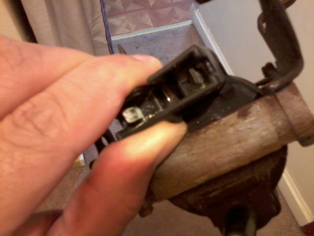

This is the Ford Coil Pack Test.
1.Disconnect the ignition coil connector, then inspect for dirt, corrosion and damage.
FAILED, CRUSTY WHITE STUFF ALL OVER
2.To check the coil's primary resistance, connect an ohmmeter to the coil's positive and negative terminals. If the ohmmeter reading is 0.3-1.0-, the primary resistance is okay.
FAILED,AFTER CLEANING THE TERMINALS, NO OHMS EXIST
3.To check the coil's secondary resistance, connect an ohmmeter to the coil's negative and high voltage (output) terminals. If the ohmmeter reading is 8,000-11,500-, the secondary resistance is okay.
FAILED 7,400 OHMS IS THE BEST I CAN READ
Looks like its time to buy a coil pack, the connector pigtail, and the rubber boot covermissing.
Im not sure if this is a symptom of water intrusion or a fried coil.The grounding to it on the fenderwell checked perfect as well.
