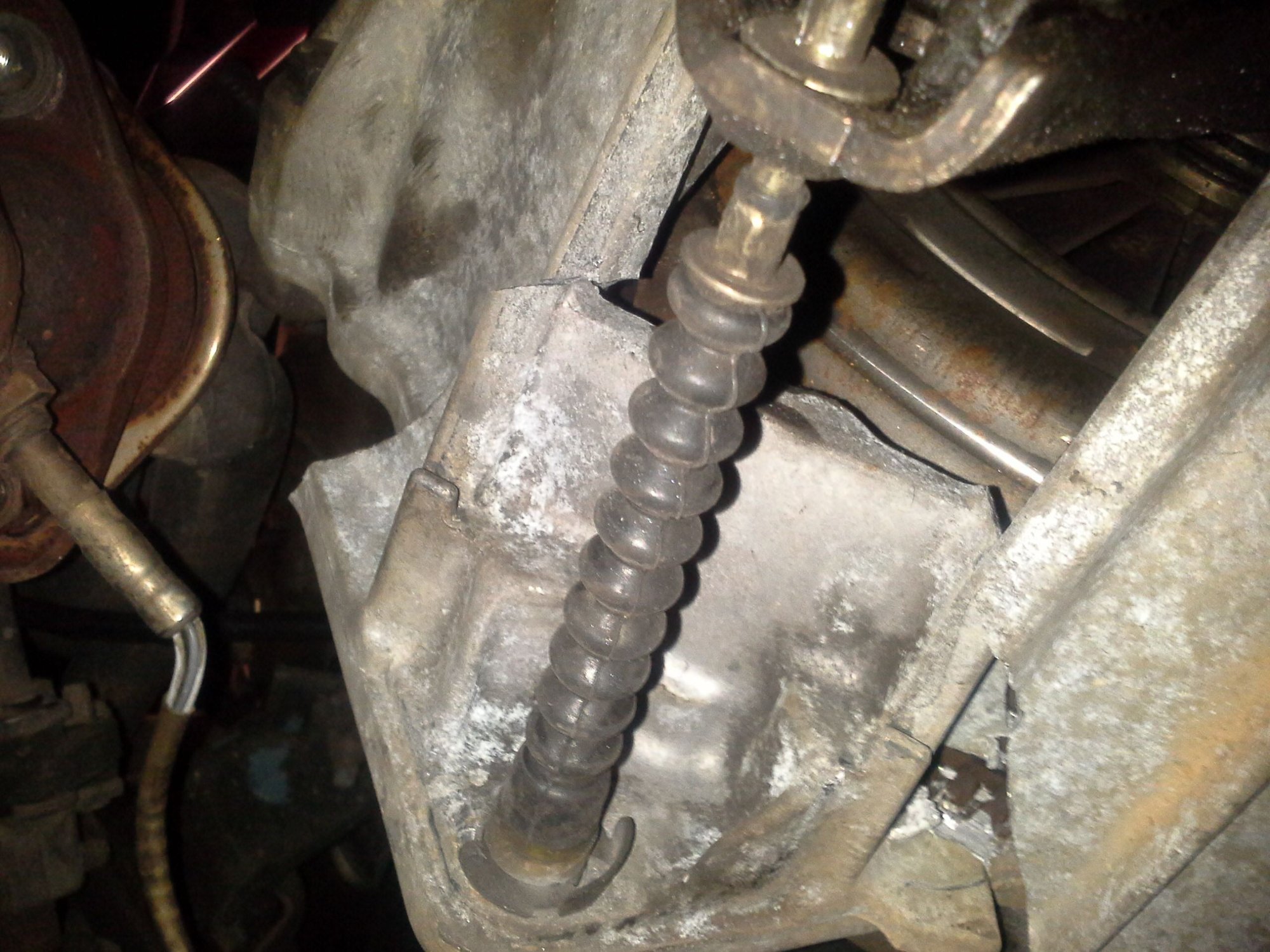

The new bellhousing is cracked. In a V shape at the clutch cable inlet. Is that bell housing still available?
What causes this? Need some help before it happens again with a new bellhousing!

Yea I still have it,
Ill pm you the details in the morning. $100.00 plus $25.00 shipping , but you have to find out what is stressing it.
It could be anything from the motor mounts being bad to transmission mounts, drive shaft bent, ujoints, pinion angle. Im leaning towards a bad motor mount, but I wouldn't know with out being there to look at things my self.
When motor mounts go bad especially the drivers side, the engine will twist violently. I say especially drivers side because that's the side that wants to lift up when you accelerate hard. If it lifts to far it can put a bind between the engine and transmission mount and it snaps at the weakest point.
Have someone stand out side the car while you release the clutch and see if the engine is twisting upward.
