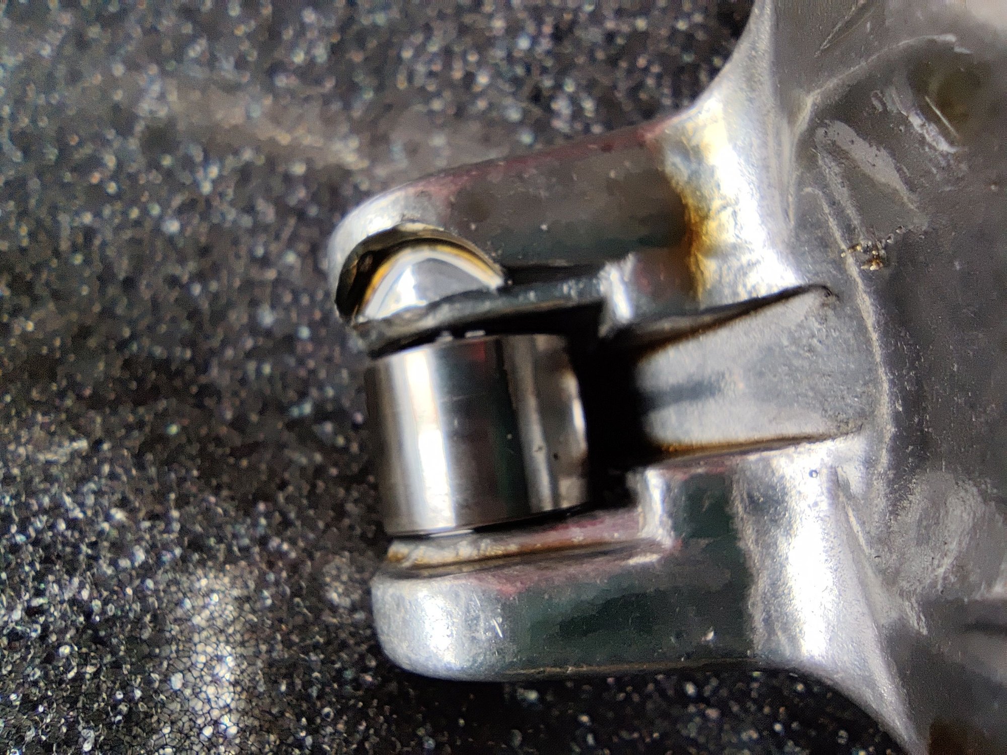

This may be the problem, maybe bent a pushrod? Just popped the valve cover off and saw this. Didn't get a chance to take the rockers off, will post an update

There it is. I pulled off 2 rocker arms that looked like this. Now I'm worried, aluminum shavings I hope won't destroy my rod bearings. I only ran the car for about a minute once the noise started. Pushrods aren't bent, I guess the rockers just came loose all of a sudden.
Also, when I took them off, a stud broke inside the cylinder head! the last 1 cm of the bolt is still in the head.
Not very optimistic right now, looking like I'm gonna have to pull the head. It would just be very disappointing to get the head fixed and then get rod knock from the aluminum shavings a few days later.

You'll probably be ok if it only ran for a short time, obviously change the oil after you get everything fixed weather you pull the head or not. Honestly removing the heads on these engines isn't that bad, more of a pain in the *** than anything
