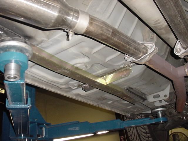

My seat bolts were long enough, didn't have to change them.
Not a great pic but.......

here's mine
http://s242.photobucket.com/albums/f...t=DSC00033.jpg

Thanks for the pic. I noticed that your rear sway bar is mounted to the outside of your lower control arms. I'm thinking mine is incorrect. I have mine on the inside of the lowers. I wasn't sure since they appear to be best fit right in the middle of the control arm.

MJR is that sway bar a kit? will it mount to a stock rear end housing?
