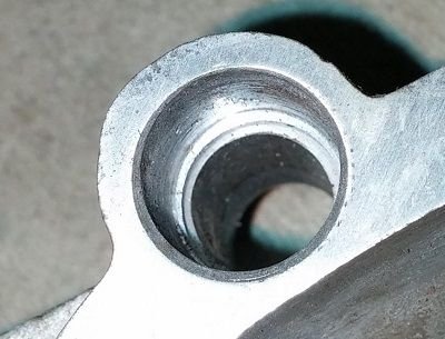

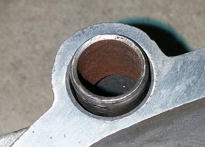

Do the 5.0 timing cover have a stepped dowel or special sleeve on drivers side ?
Is it supposed to be loose?
The driver’s side of the timing cover has a step and the dowel is too small and there is a big gap. The hole on the passenger of the timing cover is straight through and the dowel fits nice and tight. Both dowel holes on the engine are same size and the dowels fits fine.
My 5.0 is out of an Explorer and I am using Explorer's timing cover. I have seen this same step on the other 5.0 timing covers as well.
Thanks
Waid

both sides have a dowel and the dowel should remain in block for easy install.....if using explorer timing cover...better make sure that the water pump that is required for that timing cover will allow proper belt/accessory alignment and that it runs the proper direction...iirc reverse rotation is what a fox WP runs

I spent some time on my little hobby mini-lathe and made the stepped dowel. I need to align the timing cover perfectly because I will not be using a gasket.
