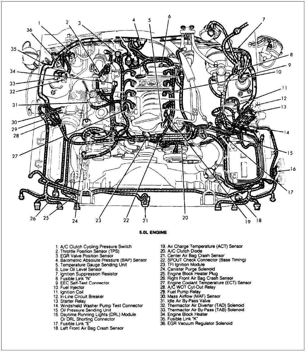

does anyone have an exploded diagram on the harneses for the 1989 for mustang LX.engine and behind dash
