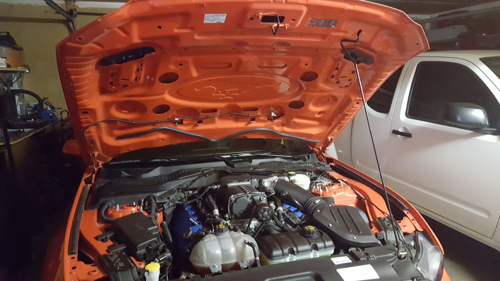

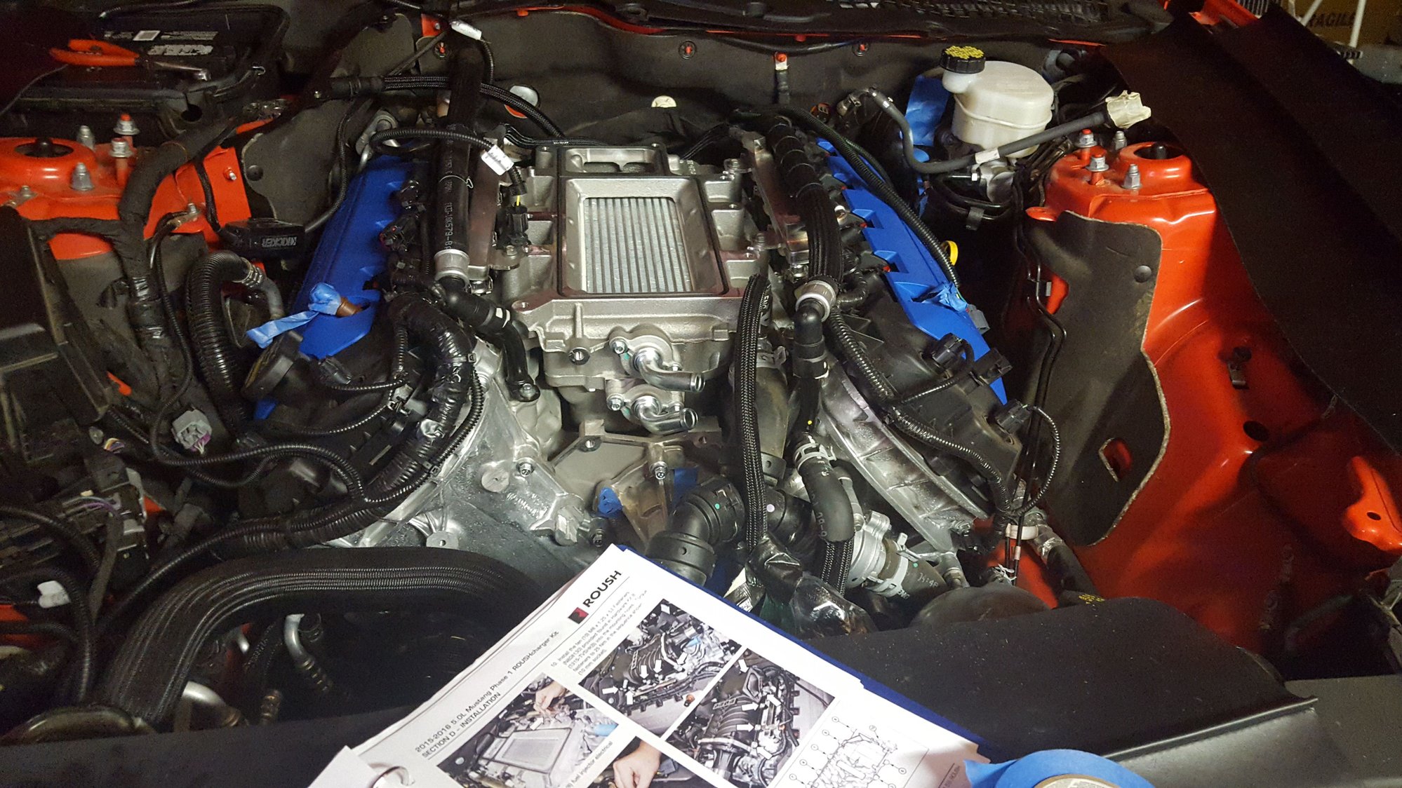

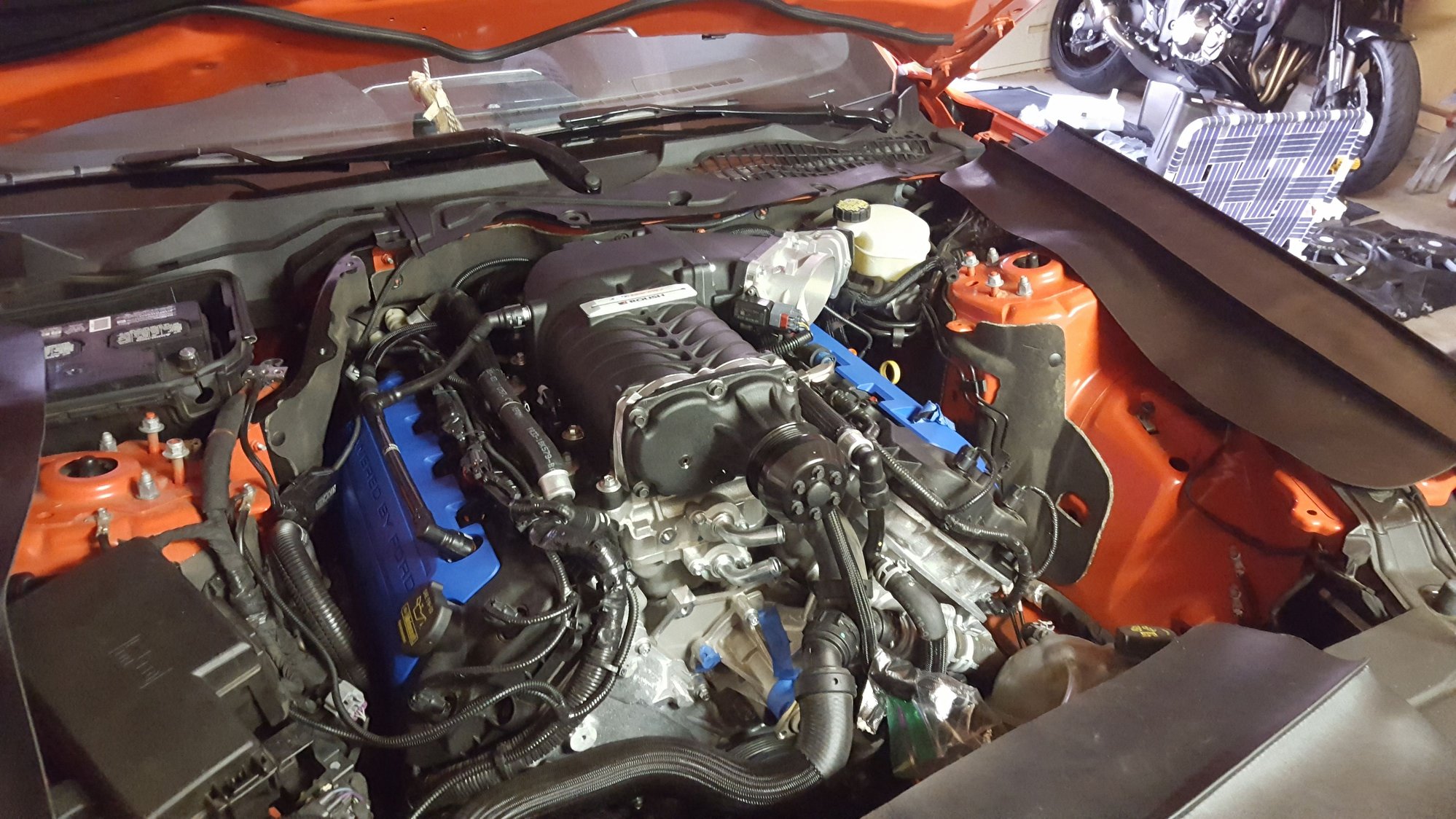

More pics of the install. If you are not afraid to use a grinder on the timing cover bosses this install is pretty easy

Also i cheated i did not remove water pump and heater hoses for the install. If you use a dremel you can get in there and cut without removing all the extra bits and draining the engine coolant

When all completed i also removed the hood sound blanket as i like to hear the whine from the supercharger in the car. I have a new hood on the way that will not itilize it anyhow

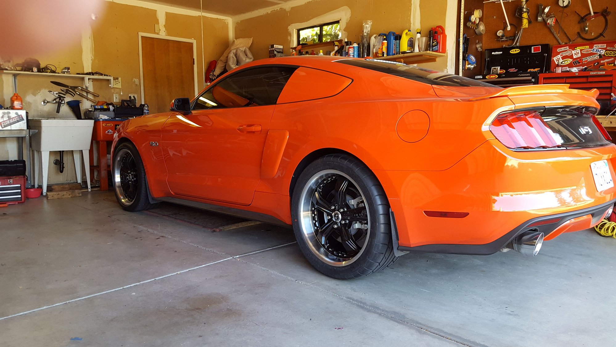

Last but least was the 305/35/20 mickey thompson steet comps to put all this power to the ground and these tires are awesome with 670 Hp they hook up good

20 Bonus points to you for sporting the KTM and riding gear in the picture as well.
Yeah now you can see why I wanted the orange stang ha ha
