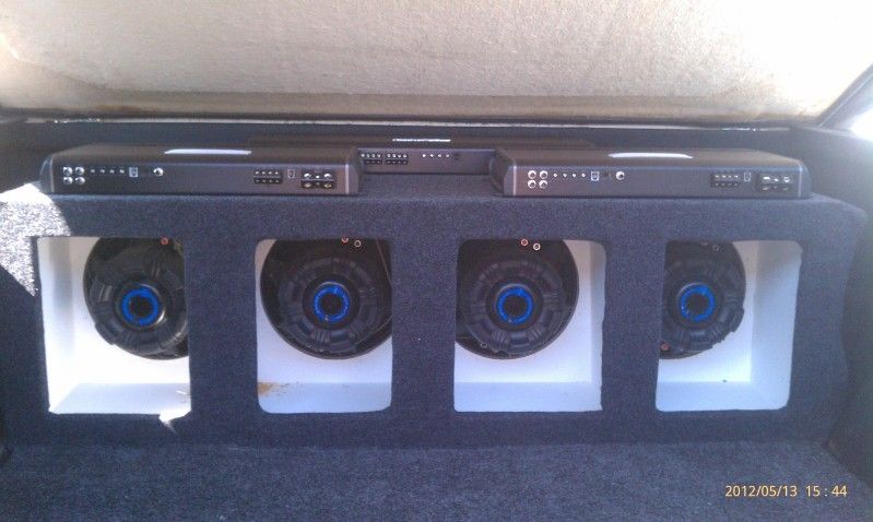

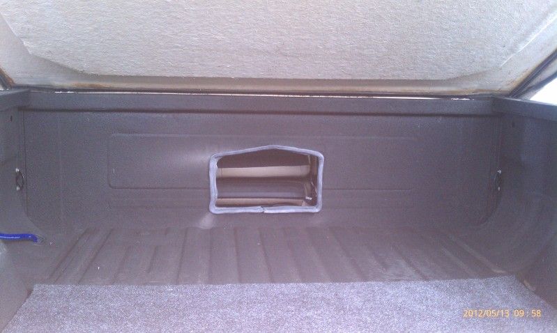

Since i got rid of my 06 GT Convertible after it was broken into.My truck is getting the attention now.I putting in 4 Phoenix Gold Ti 12D4 powered with 2 Phoenix Gold Ti 2500 monoblocks and 1 Ti 1600.5 powering 4 pairs of Ti 6.5 Elite components(as soon as they come in the warehouse)The rest will changed to the Elite stuff in a few months. The box is a blow through design with each sub getting about 1.52 cu. ft. lighted with blue neon rope, ported into the back of the cab and 1" plexy rear panel. All the RCA's are Stinger 8000 series,batteries are 3 SP1500D, PAC 200 amp isolator, and all Stinger connectors,blocks to the Stinger 0 gauge.I migh put a Stinger 50 farad cap if theres room.The doors will 'glassed with 2 pairs of the 6.5's.The head unit is a Pioneer X910-BT(that i dont like).

couple more pics, im running the 0ga this weekend, and wiring the isolator and 3rd/4th battery.

Default Got little more done
and need to start the wiring now
