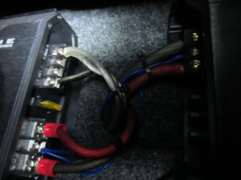

This is a kicker dx1000.1 amp.
This LED is red. Yesterday the LED was alternating seemingly randomly between green and yellow. One of my buddies who knows more about car audio was saying that he thought the amp was not getting enough power. During that time, we were cranking it up and listening / watching the woofers bouncing in and out and having fun. I honestly didnt know if he meant it wasnt getting enough juice from the battery or I hadnt turned it up loud enough...
Last night when we were driving the car, the subwoofers quit working completely. I put it in the back of my mind to check out.
This morning it was nice and cool, about 60 degrees. I started the system to take pics so I can ask for your help. When I first got it going, the light on the amp was amber. I got in the car to adjust the volume as I was afraid it might be a little loud too early. By then, the subs had quit working again and the light had gone red. Not more than 20 or 30 seconds. Reading the manual on it, here what it says.
"Red LED on, no output? 1) Amplifier is very hot =thermal protection is engaged. Test for proper impedance at the speaker terminals with a VOM meter (see the diagrams in this manual for minimum recommended impedance and multiple speaker wiring suggestions). Also check for adequate airflow around the amplifier, 2) Amplifier shuts down only while vehicle is running =voltage protection circuitry is engaged, Voltage to the amplifier is not within the 10-16 volt operating range, Have the vehicle's charging and electrical system inspected, 3)Amplifier will only play at low volume levels = short circuit protection is engaged. Check for speaker wires shorted to each other or to the vehicle chassis
I'm thinking it's number 2, but I honestly don't know at this point. The couple of guys that I know have xp with audio have glanced at the setup and they think it was built well so that's a good sign.

Looking up the model numbers of this stuff, I realized that those are 3 different amplifiers. I don't know what unfortunately goes to where, but if I had to guess since everything else seems to be making sound (this was originally a Shaker 500 car) maybe the kicker dx1000 is powering the subs, the RockFos amp the door subs (which too appear to be replaced from what I can see through the grill) and the Kenwood Excelon the normal door and back seat speakers?

New update. Wife took car to work. She said the stereo quit working altogether. The head unit still has juice and the car is running fine, so Im thinking now that maybe when the SC was installed, they didnt hook the lead for the alternator back up on the trunk battery and so it's completely discharged and that battery is dead or too low to power anything. I'll know more tonight or tomorrow.

I'm not a pro but have installed many stereos and it's kind of a hobby of mine.
First thing, I would pull the subs out of the box and check for a loose speaker wire or a cut along the length touching metal. A short there would throw it into protection mode as a power cable short would pop the amp's fuse or cause a fire.
OR
If you're running the factory alternator, chances are the charging system is at it's limits and you aren't getting enough power. A second battery isn't that much help if the alternator is struggling to keep the one under the hood charged, now it has to charge two batteries.
Too much equipment for a 'Stang if you ask me. That looks like a nightmare to keep up with and tune properly.
