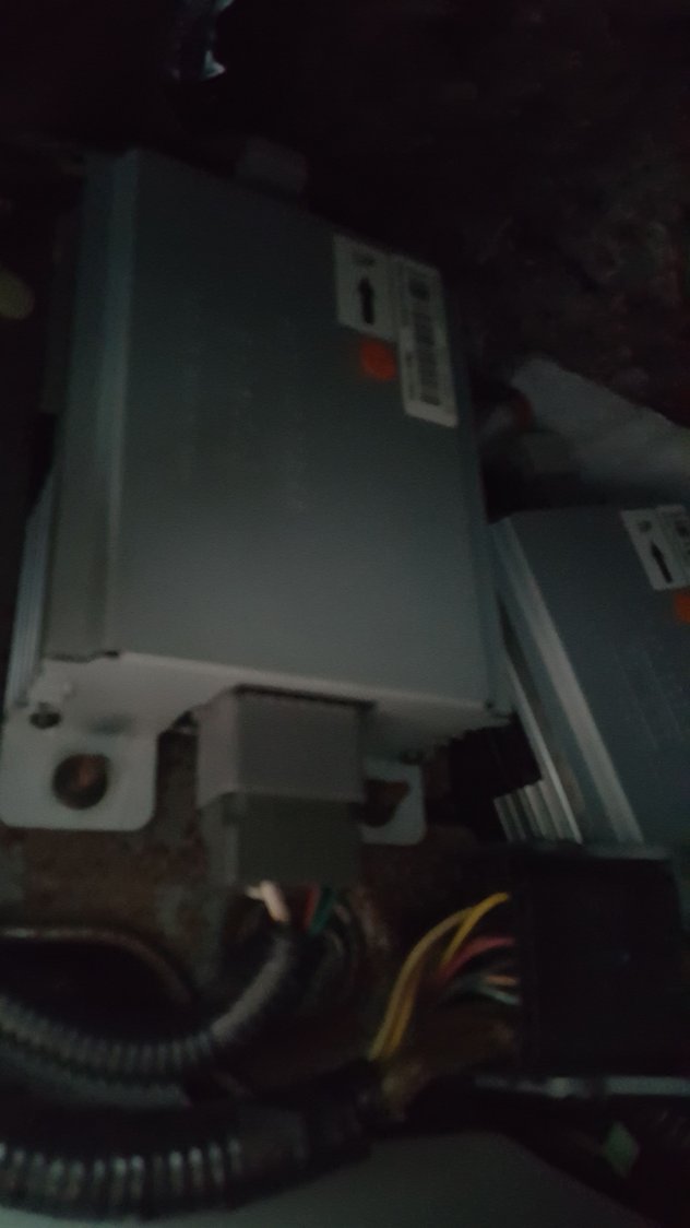

Okay so update: i drove the car home and the speakers were doing it so i found the amp where you said and tapped on it. When i tapped on it the speakers made a static noise. So the i turned off the car and unplugged the harnesses into the amp and there was like a yellowish residue on the prongs so i whiped it off and pluged them back in and drove again. This time is didnt go static as fast but it still did so this time i drove it home and unpluged the harness again and there was even more yellowish residue. Is this supposed to be here??
Also you said something about like tightening a metal clamp or something. Which i know exactly what your talking about on a normal amp but the amps i have just have harnesses into them theres no acutal wire to clamp connection.

I was talking about the metal tabs on an RCA jack but it sounds like you don't have those. It would be the tabs on the black connector in this pic.
Don't know what the yellow is, but could be your problem. You car isn';t leaking into the interior is it?

No it looks like this. Sorry i can get a better pic later. I literally pulled over to the side of the road to take this haha
