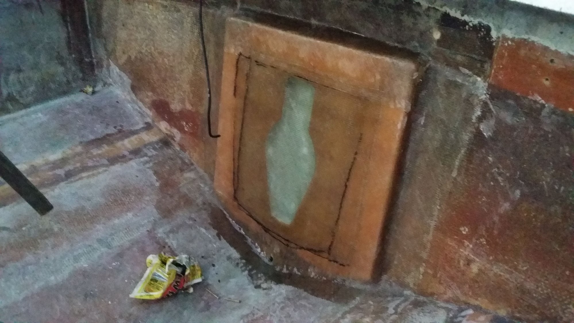

Smoothed out the outside of the transom and filled in some of the gaps in the plywood. Now the transom plate mounts up like it should.
Got the stringers rough cut on Friday, my brother in law is gonna square them up on his nicer tools. Then spent the rest of the day installing a lift kit on the jeep. Didn't wash my car for the dragon either hehe.
Before
After
Then tonight I finally got back to it, put the last two layers in the transom to even it all out before the skin gets put on. Have to wait for the resin to harden before I can cut the keyhole out (again)

The first layer of skin didn't go too well, hadn't done a sheet that big before (40x40). Ended up with a few wrinkles I had to relief cut and gunk up my scissors. Still had some bubbles in it when the resin started, so I'll be out there with the Dremel tomorrow knocking stuff doWn. Can't do anything about the air pockets (all at the corner radii where the transom meets the hull) so I'll just apply lessons learned and move on. Gonna relief cut this next sheet and wet the back side really good before I put it up.
