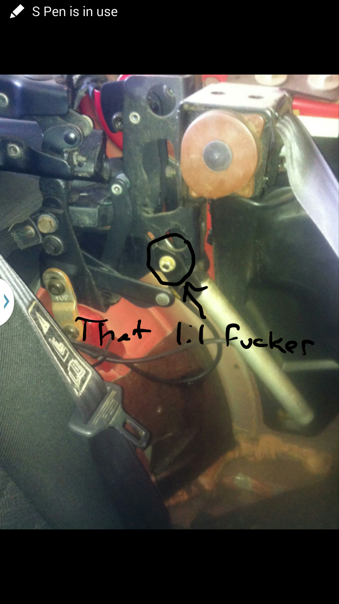

With my son's help (taking out the rear seat) I pulled the plug on the hyd tank for the power top, it was low or empty. We started off with 5 oz of trans fluid and then cycled it 5-6 times got a lot of air. then had to add in 3 more ounces for a total of 8 ozs. I don't think the po ever checked the tank.

The pump is loud but I do have a spare. So it's working a lot better now.

If your pump goes out you can disconnect for a manual top. Does it take transmission fluid? Thought it took power steering stuff.
Manual disconnect below, sorry bout the language (I wrote it 2 years ago)

Yep takes Dexron 3 trans fluid. A manual top would be easier sometimes.

Todd's experience was it went down just fine, but it was a heavy top to get back on, and if it was cold you could forget trying to stretch it back. But it's a good backup plan if the pump gives out.
