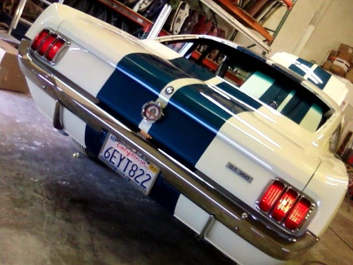

My clone is far from stock with its pretty healthy 351W, so this looks like something I should pursue.
Here is what one source I found said:
Did not come in a 64-66 coupe or fastback
Did come in the 64-66 convertible
Seems like a mixed bag of cars that came with without starting in 67

Hey Musniki, I am in the same siuation. I am just wrapping up paint and wish I would have lowered and moved my seat position back, as well as added torque boxes....before I painted!
