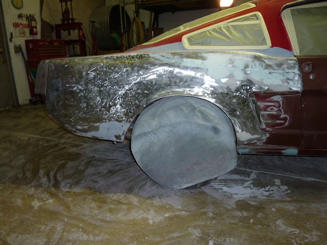

Yes you can! See the pictures below...my car was once a coupe. Andrew is correct however, it is much better to start with a fastback. This is not something that can be done in the back yard. There are at least a dozen parts that are not reproduced that you will spend $2-$3K+ and a lot of time trying to wrestle up. In the end too, having the car a conversion will reduce the value for resale, if that is a concern. Since I was building a replica of a GT350, it didn't matter to me that this car was created from a coupe. I picked this car up with the fastback top on, but not all the pieces are there and the car basically needed a total restoration. All the seams were fiberglass sealed and all the internal welding completed. From a metal standpoint, this car is identical from a factory fastback. There are a few brackets for the fold down seat that I did not put in, since the car is using a rear package tray that I fabricated, but besides that they are identical and equally as strong mechanically.
Here is a picture where you can see where the top section of the donor fastback was attached to the coupe body below. This rear panel was completely reworked as it was not shaped correctly, due to a few prior accidents.

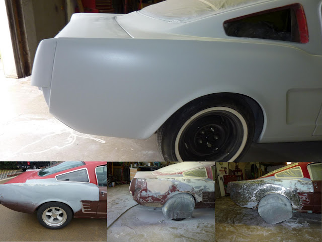

Here is a picture that shows the progression of the panel:
