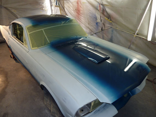

Car in "paint booth", which was plastic sheeting and pvc.

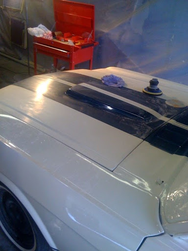

The car was wet sanded and then polished for about 50 hours.

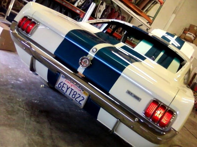

Car with the pieces being put back on.

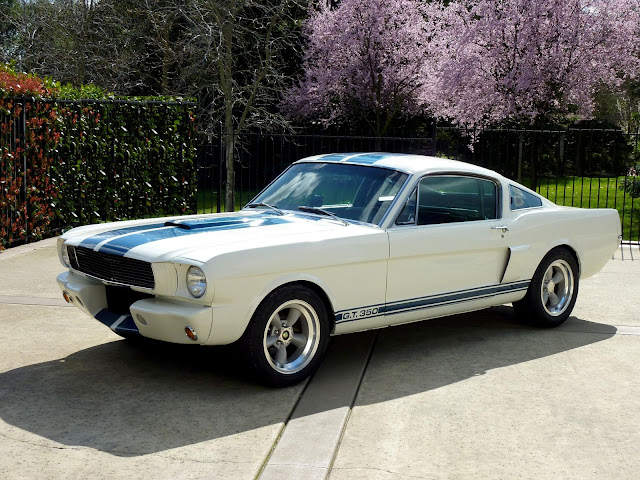

Finished car

Why did they paint the blue before the white? I'm getting close to my paint job, going with a 3 stage paint system (red) but want to also have the stripes in white. Been going back and forth on which I should paint first, was thinking color since I'll probably have 2 - 3 coats of bast plus 1 - 6 coats of mid before the clear. I still need to shoot the test panel so I'm not 100% sure on the number of coats yet. I was worried I'd have too much build on the edge of the stripe if I painted it first.

It was the painter's decision to do the stripe color then mask it. Not sure it really makes much of a difference, however I do know that the transition to/from the stripe on my car is hardly noticable to the touch, which makes waxing the car a breeze. Be sure to do tapered stripes! I've seen really nice paint jobs that look terrible (IMO) because they were painted with non-tapered stripes.
