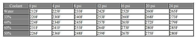

Actually your temperature sounds about right. With 50% antifreeze and 5 psi cap you could be around 240°F and still be OK. Also check that you have the spring inside the hose from the bottom of the radiator to the block. Many people forget this but it is there to keep the hose from collapsing when it is hot and the pump is pulling hard. This spring was standard in the original but will get lost, or not even noticed when hoses or radiators are changed. It is very important! A collapsed hose will reduce coolant flow to almost nothing.

Okay...while 5 psi might allow temps to reach 240 before it pops the cap...I dont think anyone will recommend running an early v8 to that temp. There is debate about what is "too hot" if we were to plot what would be considered "safe temps" base on user input on this forum im sure it would follow a typical bell curve pattern...240 would fall at least 4 standard deviations away from the mean.
I would think 240 would result in engine damage over time if not directly. 220 should be your upper limit anything between 190 and 215 should prove to be quite acceptable.
