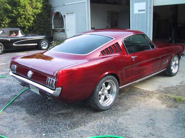

Comparitive stances:
275s in the rear:
Another view: http://www.dodgestang.com/DR/275-10.jpg
255s in the rear
Another view: http://www.dodgestang.com/images/hires6.jpg
