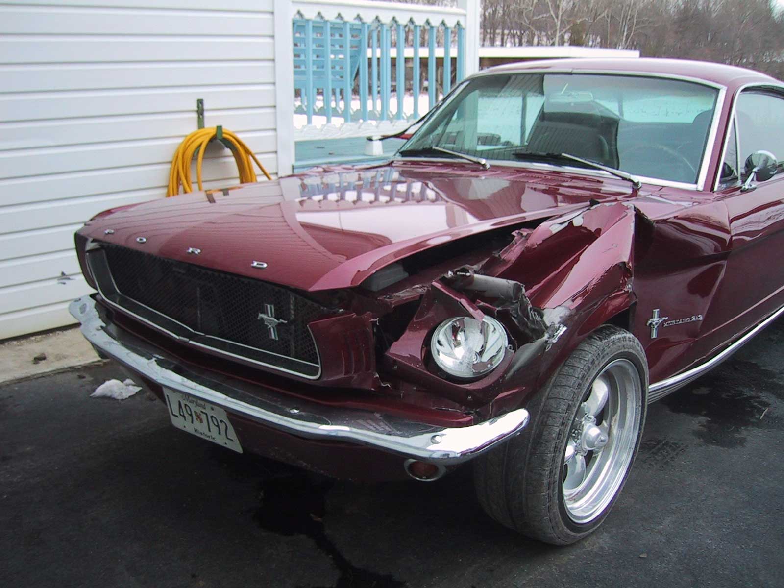

On a track a driver wants a balanced car. There is a certain someone on another forum that likes so spout off about 'loose' cars. Go to corver-carners.com and just start reading and you will know the answer and no longer have any doubt.
As for 'drivers like the end to be loose and swing somewhat out of a turn' strange things happen when your rear 'swings somewhat on a turn' because your rear has lost grip.
http://www.dodgestang.com/crash/acident16.jpg

ORIGINAL: dodgestang
A painful image. But, perusing your site, looks like your body shop did a great job of repair.
