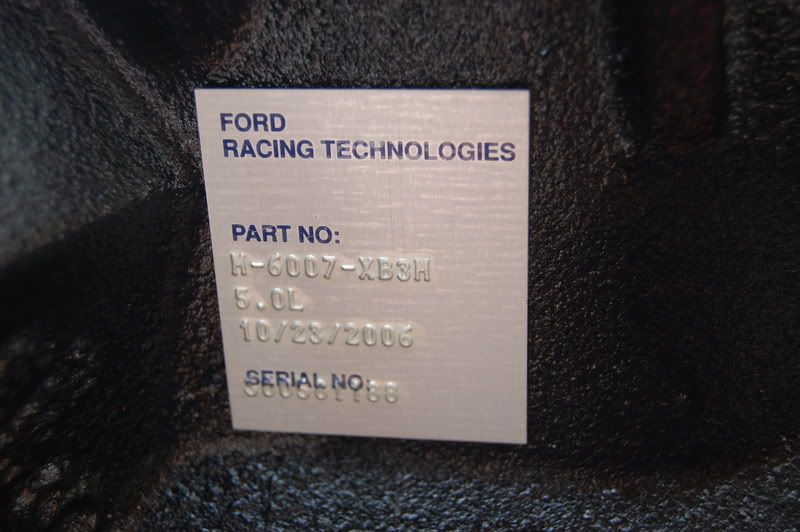

How about a 5.0L (I prefer 302 ) built on October 23rd, 2006?
