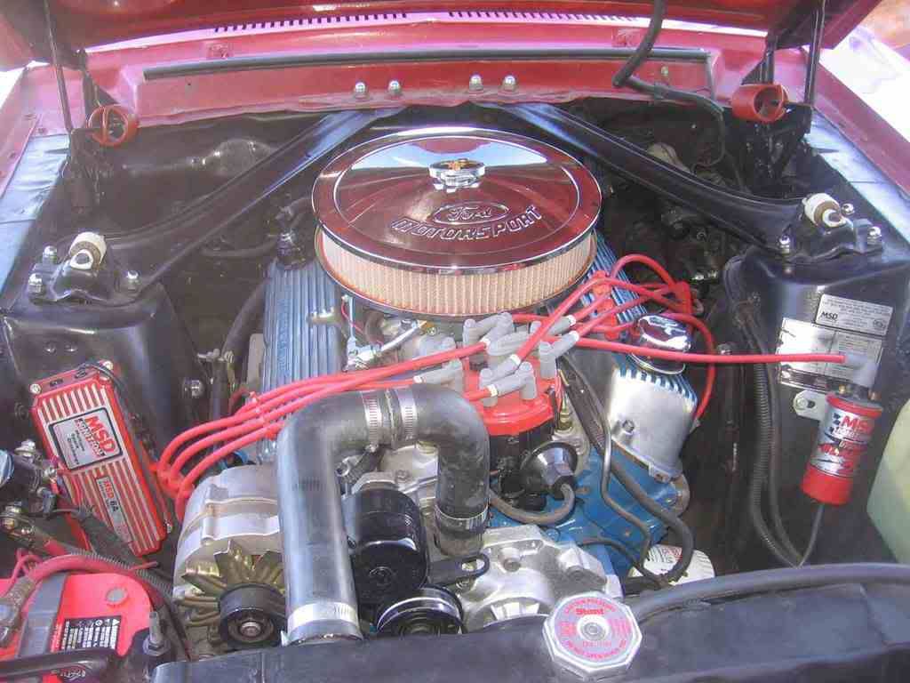

really noob to this where is the balancer located pics would be helpful ill post a pic of my engine bay :
Old May 1, 2008 | 07:20 PM
maverick75's Avatar
maverick75
Joined: Apr 2007
Posts: 180
Default RE: need some help
the balancer is behind the lowest pulley on the engine
