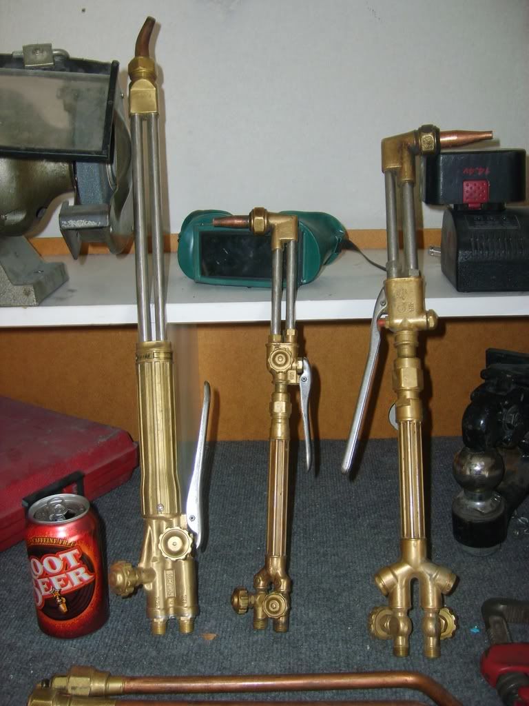

you'll need the following
oh, wait, thats just how we got the 351 out of a bronco[&:] lol
just make sure all the hoses are out, definatly take the rad out. just disconnect everything from your engine that isnt JUST on the engine

Thanks everybody , racin66coup really had me goin on that one, I was paging down slowly and looking at the pics thinkin oh no!

ORIGINAL: racin66coupe
typically i find that root beer helps in jobs like these.

ORIGINAL: Waffles
lol i was gonna say that.
or beer .
