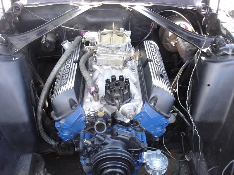

whats up with the sideways carb[8D]

just the way it sits on the intake.. i thought it was weird too

I like the black water pump and thermostat housing, it blends in well with the valve covers and breaks up the blue nicely.
on a side note, theres a small hole in your shock tower. i wonder how that got there
now get everything else in there!

what brand intake is that?

Id paint the master cylinder and brake booster.

Looks good. Ace the purple anondized fittings though.

isnt that an old holley intake?
hey man, look at where your fuel line is going to com into that pump, your gonna have to take all those allen screws out and rotate that thing on an angle or your fuel inlet fitting will hit the oil filter. ask me how i know? [8D]

People have been drilling small holes in the front of the shock towers of the early gen mustangs forever to easier access the grease fittings on the control arms....they squeak like crazy and the zerks are very difficult to lube from underneath.
