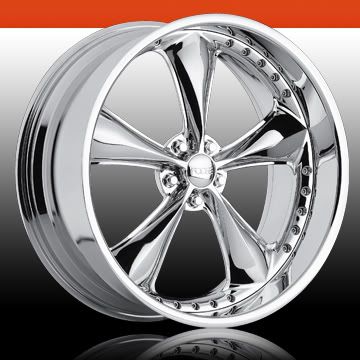

After much tought I ended up with the conclusion that disk and drum should be the same backspacing I hope I'm right. They called in and gave the clear to run 17x8 up front and 18x8.5 on the back. They told me if they didn't fit that they would change them as long as they didn't mount any tires on the wheels. I got a 4.5 backspacing in the front and I got a 4in backspacing in the back. I am going to go with 235/45r-17 up front and 275/40r-18 on back. It ended up being a little more expensive than what I was hoping to spend. I got some foose nitrous chrome, I was debating on those or some boyds. A new style called espada but these where to expensive. They should arrive thursday. What do you think did I choose right? Espada
nitrous

+1 on the nitrous thats a very cool wheel.

AR has the same rims as the Nitrus rims with out the silly dots. killer rims, have them on my 06

I had the foose Nitrous on my 06 charger. I HATE THEM. THEY LOOK GREAT BUT I CANNOT GET THEM TO BALANCE. I EVEN SWAPPED OUT THE TIRES AND NO LUCK.
Thankfully my wife came out in December to go to work and the car was on jack stands and the wheels and tires were gone. It sucked, but i replaced them with KMC SS wheels. the KMC"s look cheaper but they balance fine and the car rides smooth. The Boyds would have been a better choice. However the nitrous look just as sweet.
I put 17x8's all the way around on my 66. 18s will fit i have a mile of room. dont think a 20 would fit though. I wanna ride low.
watch that machined lip on the foose. anything touches them and you will have a booger. they are very soft.

I'd rather spend the money on the disc upgrade then a set of flashy wheels (those Nitrous wheels are Torque Thrust knockoffs anyway, why not get the real thing?). Not to mention, 17" wheels look freaking huge on a 65-66, and you're not getting a 10" wide wheel in there without some wheel well alterations.

The "Nitrous" rims without the dots will look great, especially on a dark car. Be careful on the size as it may look goofy on a 5 or 6 unless you re-radius the openings (which I like).

Thanks guys. I actually wanted 17x7 up front but they told me that they didn't make them or they didn't have the right backspacing for me. So I had to go with 17x8. What are the differences you talk about when you say handling,"this will help with turning and handling?" I'm I going to have to give a bigger turn for them not to hit on something? And handling is it a harder ride don't understang.(sorry just got out of work and I have only slept 4 hours the past 24 hours). Could you explain it some more.
Mortman, which wheels are they can't find them?
MonsterB, Why weren't the tires able to balance did they let you know a reason? I had seen the KMC SS before but they weren't available for my car. You say you have 17x8 all around how is you drive? they say something about handling and turning. Are you having a problems? I also want a low ride look(not lowrider). I had thought about 20 in the back but after thinking and seeing the prices they were out of the question.

67 evil, love your car. I'm still tring to see which rims are those but can't find them. I actually like the dots. How do you re-radius the openings never heard of that before. Here is a pic of my car it's not to dark(except the tint). At the last moment I was going to go with the tt stylem but I couldn't get a bigger lip for the back. They were going to be 17x8 all around. Liked those since I first saw them.
