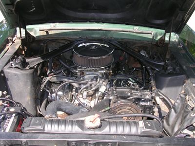

BEFORE:
(old crappy small air cleaner and shock towers that needed TLC)

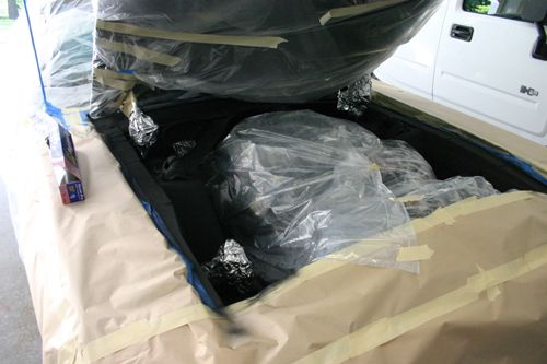

MASKING:
(I think I over did it, but I did not want to risk a $3500 paint job)
