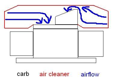

here is a very crude drawing to show what the air flow restriction looks like with a drop base aircleaner like alot of you may have due to hood clearance issues and the choke tower blocking the airflow.

On a race car, removing the air horn allows air to more easily flow into the top of the carburetor. It will also do the same thing on a steet car, but.......
.......on a street car from which long engine life is desired, removing the choke is very unhealthy for the engine. Without a choke, you have to pump the accelerator on cold starts to squirt some raw fuel in for startup. This raw fuel dillutes the oil on the cylinder walls RAPIDLY wearing the cylinder walls, pistons and rings.
Several years ago I bought a phenolic gadget that slipped over the top of the carburetor to funnel in air. It works REALLY well and allows you to keep the choke. I don't know if they are still available and I don't remember what they are called, but it would be a GREAT compromise for a street car.
