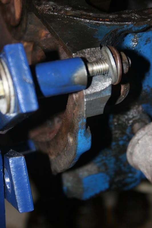

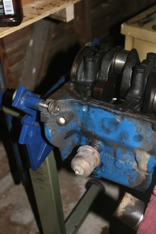

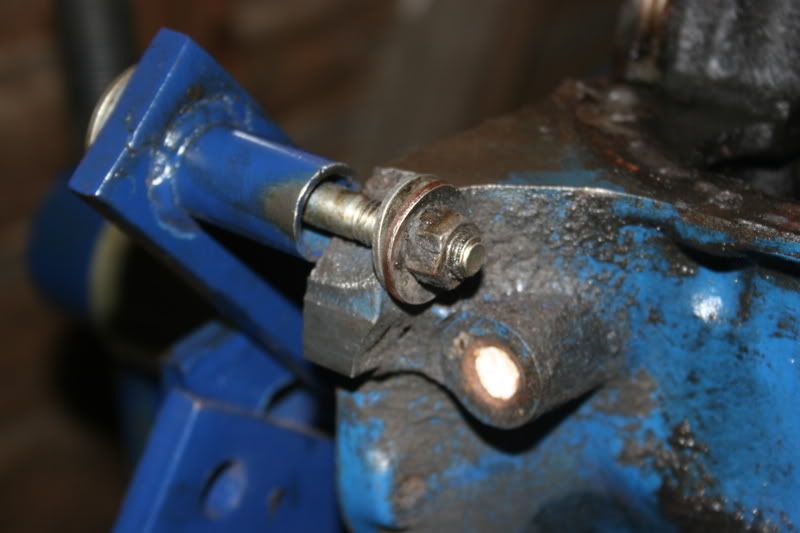

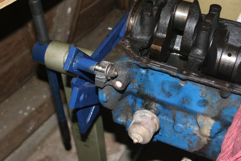

Hey guys, I have a terrible feeling I made a simple mistake.
I picked up a I6 engine from a guy off craigslist, and it was a sweet deal plus he threw in an engine stand all for $100. He said it came out of a 1966 coupe with only 50k original miles, I didn't really believe that upon seeing the engine, but the condition looked ok.
Anyway, I was stripping it down and cleaning off all the grime, and I saw this.
http://img.photobucket.com/albums/v1...necrack001.jpg
http://img.photobucket.com/albums/v1...necrack002.jpg
http://img.photobucket.com/albums/v1...necrack003.jpg
http://img.photobucket.com/albums/v1...necrack004.jpg
I was so busy looking over the block for cracks or damage that I didn't even see this.
So my question is, is this worth rebuilding? All other engine components look to be in good condition, though there was quite a bit of rust throughout the coolant chambers. My guess is that the engine sat with fluid in it for a number of years. {i was able to drain a couple quarts right off the bat.}
So I'm hoping that I can repair this missing portion or somehow get it running.
The end goal is that this will be a low-low-budget rebuild so that I can rebuild my original engine in a "proper" manner. It's a daily driver, so I would have to just do a swap.
Thanks guys,
Nick

It may be possible to get fixed. But at this point just resell and pick up something better is what I would do.
Old Nov 9, 2008 | 07:18 PM
Joe67's Avatar
Joe67
Banned
Joined: May 2008
Posts: 1,049
From: Maryland
a machine shop should be able to fix this....
shouldn't be astronomically expensive, but if its worth it i don't know whether it would be better to fix this one or try to find another

A new engine stand itself retails for about $100. I don't know what an I6 sells for but as long as that fix doesn't exceed about what you paid for. Also consider, you never really get what you put into a motor as far as money value goes. That is on the bottom of the motor, the seller may have not even noticed, who knows....

That is a pretty easy fix for a competent welder. Basically, build it up, grind it to shape and redrill the hole (probably the most difficult part). Looks like someone overtorqued the bellhousing bolt.
Got to be a competent welder to do cast iron, don't just drop it off at a corner barn.

Yeah, best welded with gas and the correct rod. This way you can preheat the block. The fact that it is on the edge makes it a bigger challenge.

Thanks so much for the info, guys. My computer went down right after I posted. I'll give my local machine shop a call and see what they can do.
