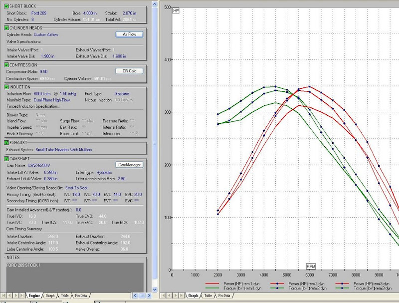

here's the results:
what i believe to be your engine, stock cam, edl performer and compcams xe256h.
I'm not an engine builder so yes, phone around, see what the cam companies recommend for your engine, transmission and gearing (how would i know better than someone who builds them).
But the compcam (the high torque) looks best from all three since you want to spin to 5500 only
since the attachm,ents are resized to **** here, the highest torque is xe256, the middle torque the edl rpm and the lowest the stock
obviously the lowest HP (red) is stock, middle HP is xe256 and high HP is edl
edl has more HP than xe256 at 6000, but you shouldn't be there. at 5500 they're the same and before that the xe256 is the clear winner.
that's all based on 289, 9:5 compression, 600cfm, high flow dual plane, edelbrocker performer heads with 1.9/1.6 valves
But i cannot guarntee what heads you have or clearance so I'd stick with what your new good reputation engine builder says. still don't understand the isky argument

Remi check email, sent the full resolution picture there. but you even get the ideqa from that minifile
uploaded as well now.
remi1-what you have (see on left)
remi2-same with xe256
remi3-edl perf rpm cam
dont take the numbers too serriously, it's just to show the difference between the cams
