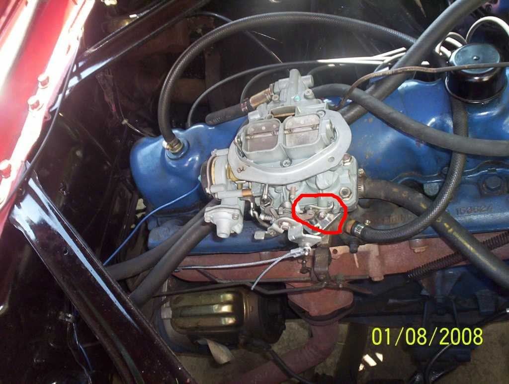

I should have a pic of it.

Ok Ignore the red circle.
You can see the spring at the end of the linkage above the date in the picture.

Yeah thanks BA that's where I thought it would go. Where does the other end attach? manifold bolt?
I went to the local mustang yard and looked at a schematic, but it had the spring going from the bottom of the exhaust manifold where it meets the exhaust (there is an extra hole) up to the end of the accelerator rod coming across the firewall. Wierd. The spring they sold me was about 6 inches too short, and kinda flimsy so I made an extension from some wire and it works, kinda.
http://s448.photobucket.com/albums/q...t=P3071038.jpg
http://s448.photobucket.com/albums/q...t=P3071036.jpg
It still doesn't bottom out the throttle all the way, so I'm gonna shorten the extension to get more tension. I'd like to go the way BA's does though. Since there's a hole on the bottom of that lever, it seems like that would work.
