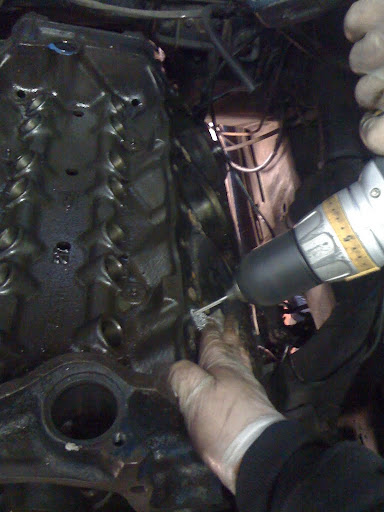

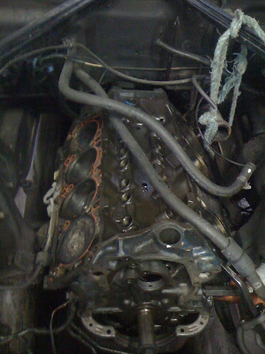

that's what we started with, 1966 stock 289 heads and cam out:
drilled steam hole. we only drilled at #1, and #5 as in manual. noone tell me now all 8 please ... :-)

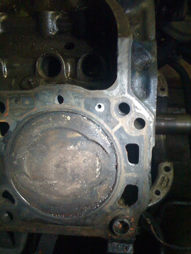

drilling for water:

timing cover back on, one head up:

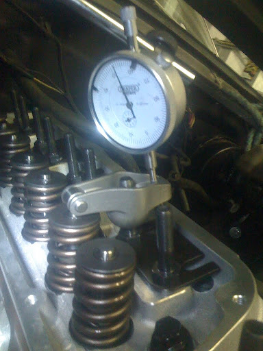

checking pushrod length:
for the pushrods: i measured how much the spring in lifter (new, not pumped) gives in, as the total length of pushrod needs to be that shorter and came up with 0.135 inch.
then we used the 6.8" checking rod (unadjusted) and checked for wear pattern and it looked good, more would bring the pattern outside (towards exhauset side of valve stem), to little and the wear pattern is wide.
but since the cam has 0.47" lift at cam, means around 0.29" at pushrod we figured half the lift is wasted in the hydraulic lifter and we can't get a proper result this way. so we slapped a used hydraulic lifter from the engine in it. got full lift this way and best pattern is between 6.7 (5.8 rod with 18 turns out) and 6.8. better towards 6.8.
So it seems those heads (in our combination) like stock size pushrods. ordered hardened 6.77" or comp cams 6.8" if they don't have the others.

Interesting, I've never seen instructions telling you to only drill #1 and #5. I drilled all 8.
Old Jun 4, 2010 | 08:31 AM
kalli's Avatar
kalli
Joined: Oct 2006
Posts: 6,417
From: Cork, Ireland
they don't specify a goddamn thing(sorry). the leaflet is as detailed as:
drill steamholes as in picture. picture shows you location for #1 and #5,
but it doesn't say anywhere if you have to drill them for all 8. ya, you could think that, but if unsure I better leave it off. The heads have the provisions to take all 8. Ya, one can assume, but no way to be sure.
that's the leaflet that comes with them:
http://www.edelbrock.com/automotive_.../5000/5023.pdf
Old Jun 4, 2010 | 11:19 AM
kalli's Avatar
kalli
Joined: Oct 2006
Posts: 6,417
From: Cork, Ireland
can anyone else confirm it should be 8 steam holes? we have another set of headgaskets, so we can still do it ... ?!
Old Jun 5, 2010 | 12:08 AM
Starfury's Avatar
Starfury
Posts: 5,896
From: Elk Grove, CA
Trick Flow says 8. I believe AFR says the same.
