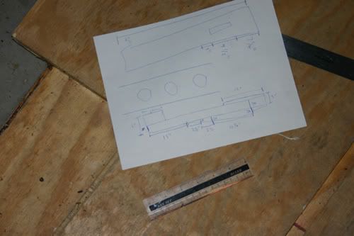

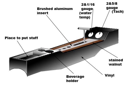

I got sick of trying to carry drinks and things in between my legs, so Im putting together this console from scratch. Thought you guys might like to check it out.
3d concept
sketchy plans

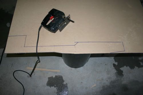

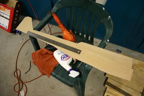

stencil on 1/4" MDF
Jigsawed pieces

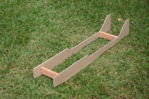

mocked up frame

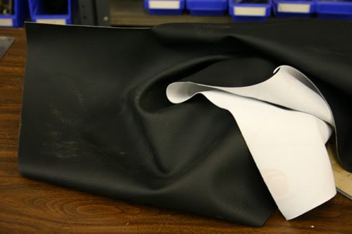

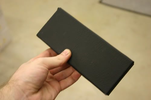

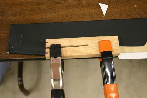

Vinyl: Bought from the fabric store for about 15 bucks a yard.
Cement:

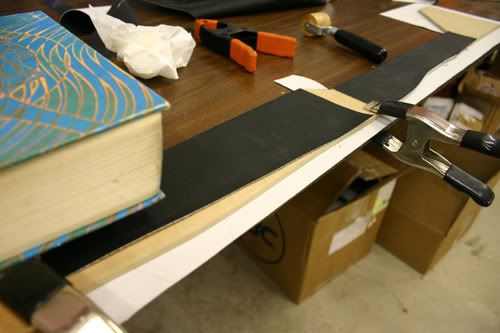

Gluing: Lots of clamps, clue, and razor blades. Not to mention the roller.
There is really no easy way to do vinyl

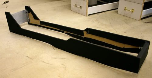

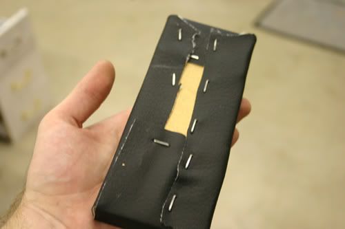

Back piece:
Back of back piece (not too pretty)
Done for the day:

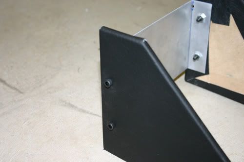

Upclose bracket: I had to fabricate this bracket to be easily removable in order to access the gauges

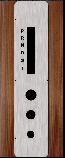

No, I think im going to make my own. Either that or get it laser cut.
This is what I want it look like ideally:
but I dont know how I would cut out the letters.
any ideas?

Default RE: Custom console
Looking Good!!!
How about using the stock console piece for a '66 Automatic. This is easily available repro, and could be mounted from the bottom of the insert.

That looks very good. I dont know how in the world you could cut out the letters, but im sure you can find a way and it would look really good.

I don't know i you guys have a company like this in the states, but in belgium there is a company called "Lasertec" . They cut out shapes and stuff in metal using lasers.
Maybe you should look for a similar company near your place do to the engraving for your console?
