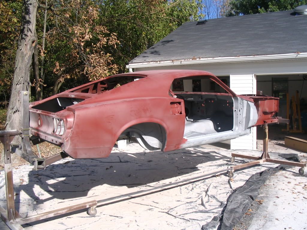

i did mine on two separate weekends. cowl forward on one weekend and the undercarriage/interior on another. i didn't blast any external panels. i used about 500 lbs of sand but i recycled it a few times. within one day of blasting on each occasion i epoxied that section.
the more you can do in one shot the better. i spent about 4 hours each time rotating the car, vacuuming and blowing with compressed air in an attempt to get the sand out so it wouldn't get in the epoxy. add in more time wiping the car down with cleaner.
my compressor supposedly pushes 17 cfm @ 150 psi. i like to make sure gauge at the tank is showing over 100 psi for faster results. my compressor ran almost continuously and i had to take a break every couple of minutes.
it was the worst two weekends i have ever had with the car. however, i know that the rust pits were clean.
