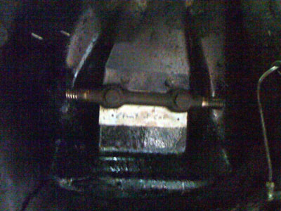

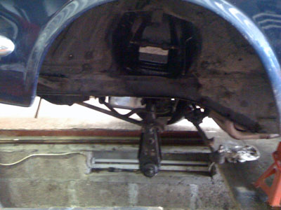

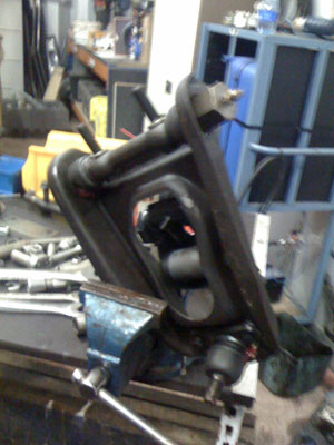

well I'd like to post pictures but it was very late last night, not enough light outside to take pictures. So they'll follow.
It's done for a while, but I had trouble with the car ending up too high in the front.
Reason was that I tightened the lower arm pivot while having them more or less hanging down.
I opened them, drove a few metres forward/backward. let the car sit for a week (was busy with other things).
Last night I adjusted camber/caster/toe in.
It's well away from perfect. but I decided to give it a good drive before I re-adjust as the suspension might settle another bit.
At the moment I have 3 degrees caster on both sides. left and right side have both 1 degree camber (0.5 more than it should be). It was getting late so I stopped.
the result .. . I have driven the car only up and down a pothole road, no heavy cornering. I can say the steering seems easier when driving slow (new bushings and balljoints?).
When I'm driving it feels like I have to push more to get the car to corner and have to push more to hold it there. Maybe I'll reduce caster a bit.
Anyway I said I'm going to give it a proper road test once it's bright outside (weekend)
I'm delighted it all went ok. I didn't drill any wrong holes and crap like that :-)

i'm too stupid for this imperial inch stuff. i meant i should have 1/8 or 1/16, went for 1/8
I never brought the good camera, only took a few snaps with the mobile phone. Will be over at car later. i.m not sure if I can actually see the car dropped. maybe after it all settled.
