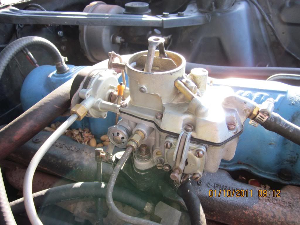

Here is a photo of my old carburator that got me 9 mpg (hiss-hiss...):

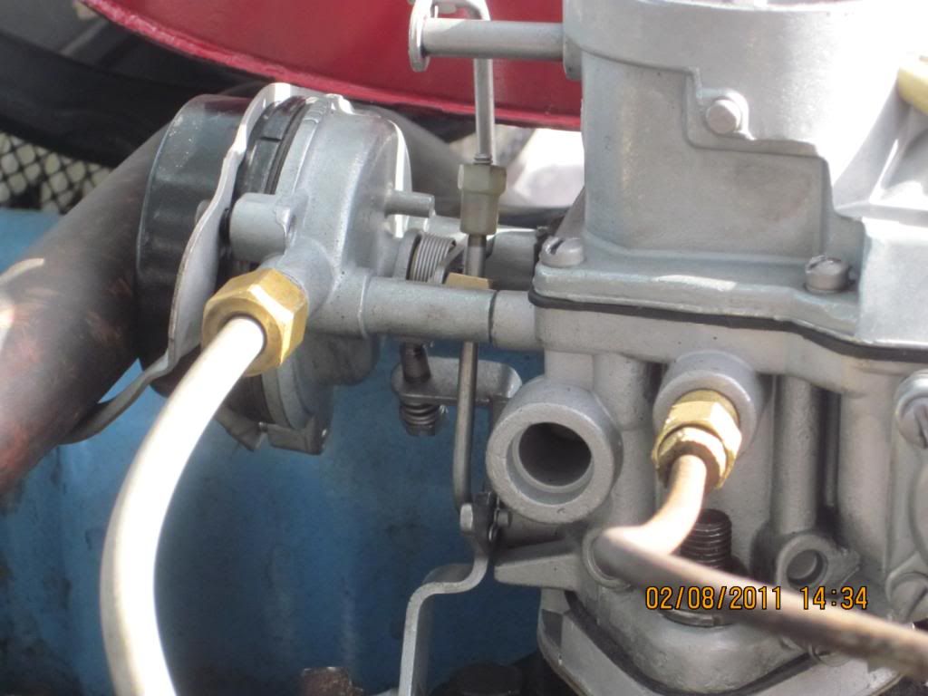

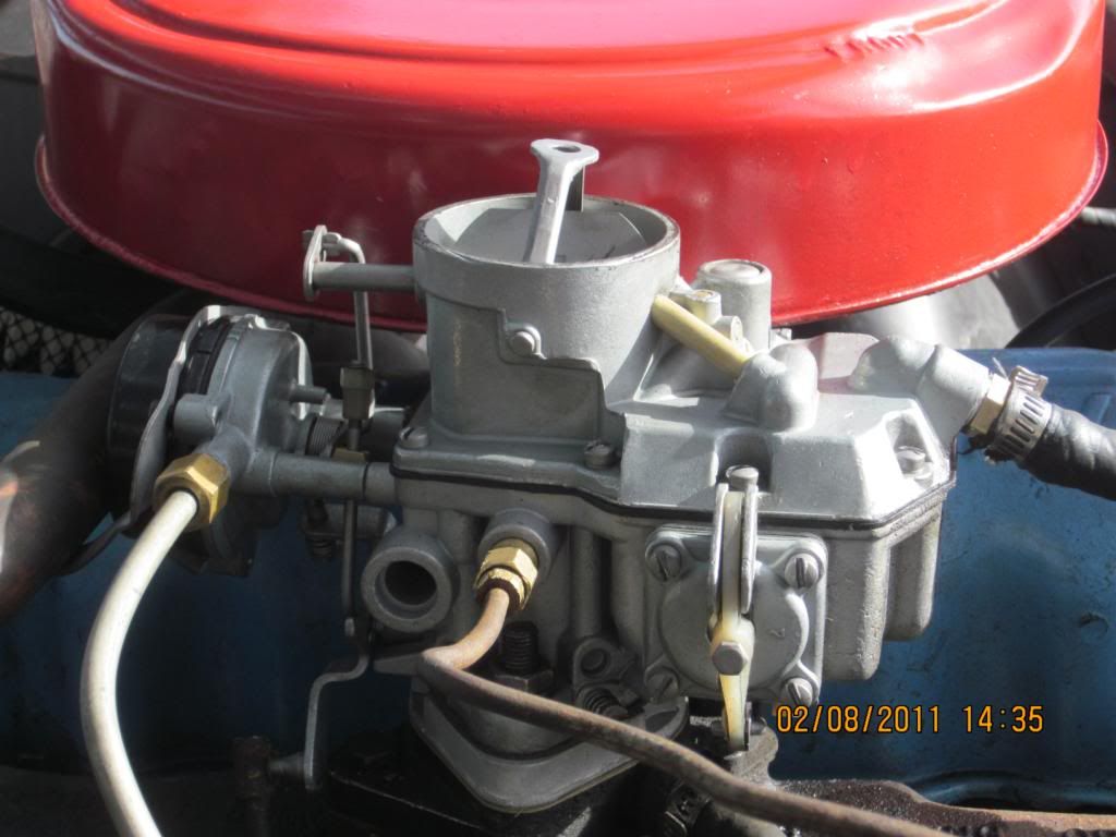

And a photo of my new carb which gets me 19-20 mpg WITHOUT the Spark Control Valve:
A closer picture of my carb without a Spark Control Valve:

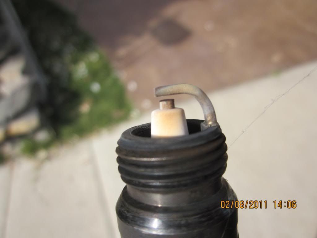

A picture of the spark plugs a week and 500 miles later:
The "before" picture of the spark plug belongs to my car, but I changed the plugs a week before I got my new carb. The point is, the plugs were totally black like the "before" photo, and the "after" photo is 500 miles later. The black crud was burned off.
So the question is, is this new carb and new distributor compatible? I am getting 19-20 mpg with an 200ci motor, and I am very happy with how the spark plugs look.
What do you folks think?

I tune my car w/ plug readings also. Gets you pretty close. Besides, Santa never put a wideband O2 sensor under the tree.
I tune each mode separately.
if i wanna tune cruise mode i key off engine as i exit freeway cruise.
pull one plug and read it. Last time I checked my cruise mode it was just off white not far off from yours.
did you pull plugs after idle or after cruise?
