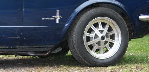

for the clearance: here's the hooker super comp for you. I'm not banging it so i'm not worried. But it really couldn't be any lower
bare in mind this is header specific, not for all LTs. Even worse the angles the two headers are coming out under the floor are different. So any prefab system you could not fit. It's cutting and welding from there:
