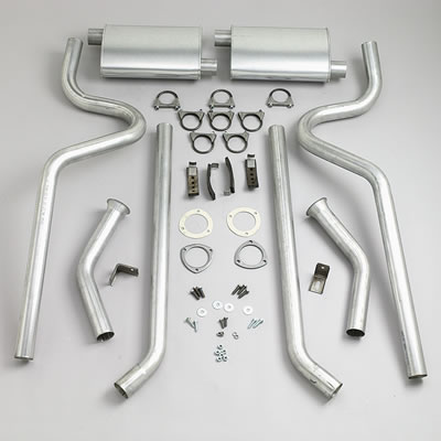

I bought this system from Summit.
I relies on the headers coming off the block parallel and not exiting on an angle.
Guess what the Patriots do? I had to cut the flanged pipe a number of ways and weld them to get the angles I needed to find their way through the tunnel and reinforcement plate.
The rear tail pieces are also a PITA and the right one hits underneath and vibrates during accel, but overall I love the sound.
This kit is definitely not bolt in straight out of the box, at least not with the headers I have and being a convertible.
I'll try to get some pics up of the install. I will definitely get some video up so you can hear what it sounds like.
I'll have to install an H pipe.
