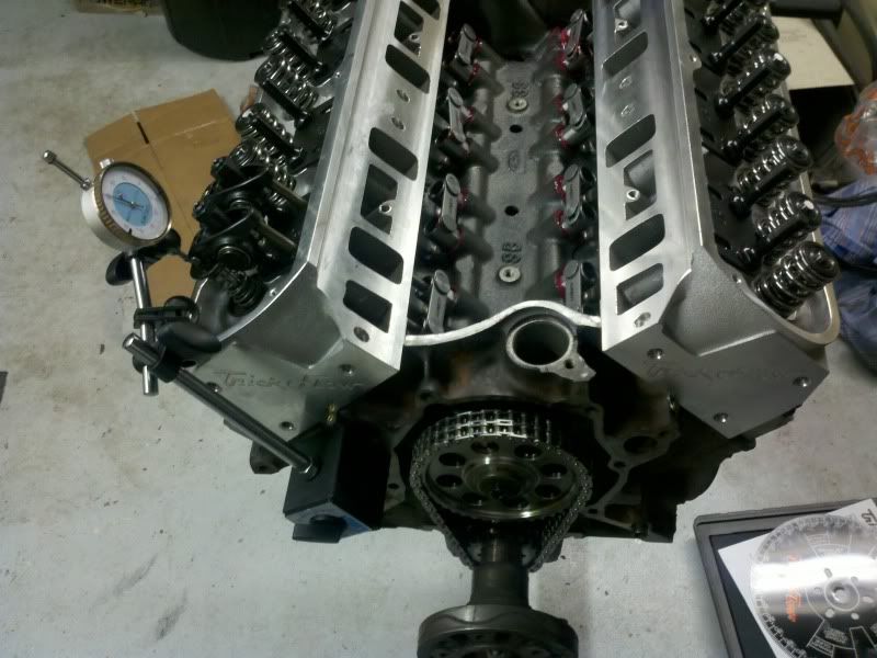

I was going to say edcurtisFTI@verizon.net but you beat me to it. Just make sure you fill out the form so he knows exactly what you have. You will still need to degree any cam you get followed by ptv and radial clearance.
I just went through all this with my 1990 302HO
