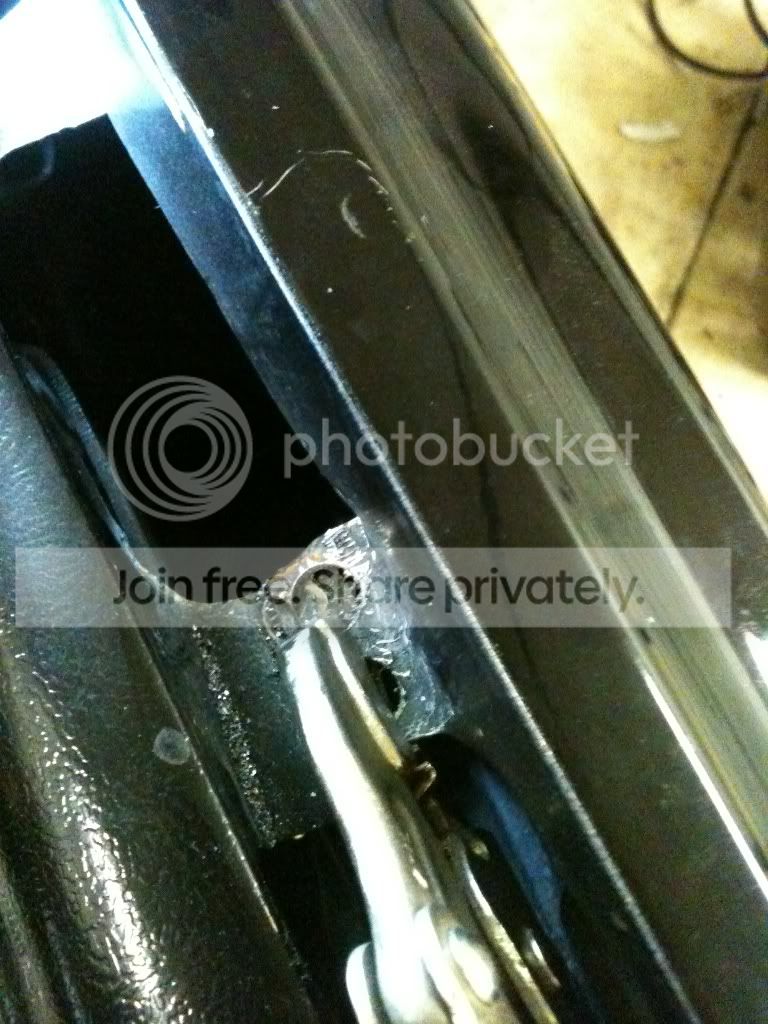

Im still a little lost on where exactly these spot welds are.... Can you discribe them a little better and show us your repair. Pictures are great for slow people likr me!!! Thanks for the help, I am also battling the twisted door fate. Brent

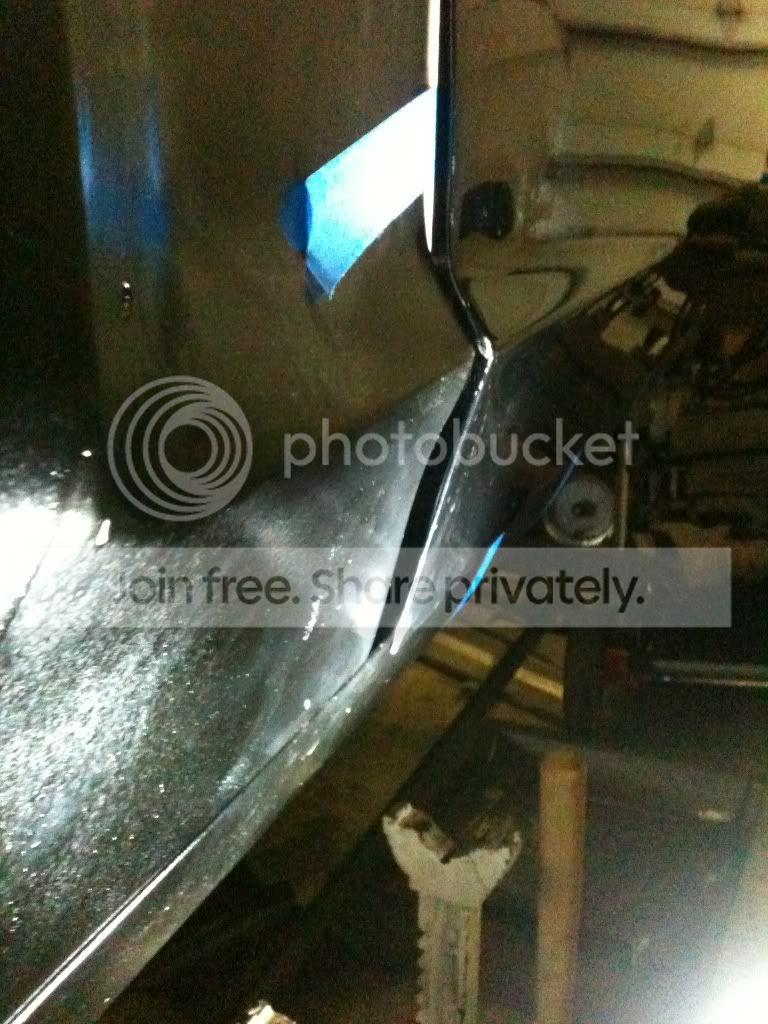

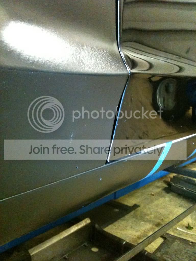

Still Need to do a final OK then weld. But dang good for ten mins of drilling 4 welds and prying it open a bit.
Old Mar 13, 2012 | 10:51 PM
jgemperline's Avatar
jgemperline
Joined: Aug 2008
Posts: 142
From: Colorado
Before:

You will also notice that the rear of the door isn't curved in like a Ford door. That is a easy fix also, just take your hammer and dolly to get the desired curve.

WOW... I was way off, A picture is worth a thousand words. Thanks for helping the kid on the short bus!!! Brent
