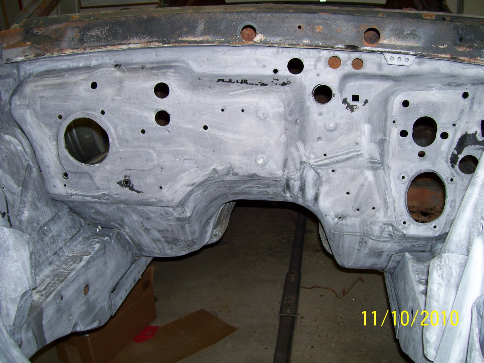

CSRP is a great resource! I recently completed this on my own 1970, but mine was a coupe and it had drums all the way around. The most important thing for you to do is to see if your firewall has a stamp where the booster should go. It should be a small line and would make the original hole appear oval. Should look something like this. http://3.bp.blogspot.com/_nJDavGdQhB...0/100_3495.JPG
Secondly, you will have to get a new pedal as well since the power pedal needs to be longer as the pivot point is higher up on the pedal assembly itself.
Again, CSRP will be a great resource for all kinds of information, and in honesty I am glad that I went ahead with the power brake system, but I don't think that it was necessary but that is just my .02
