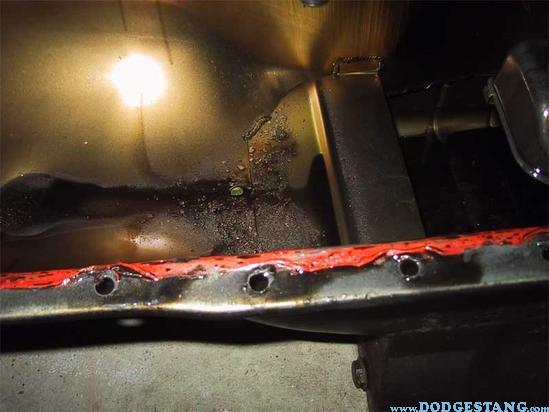

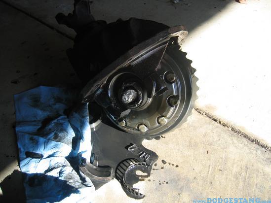

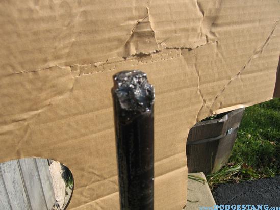

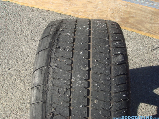

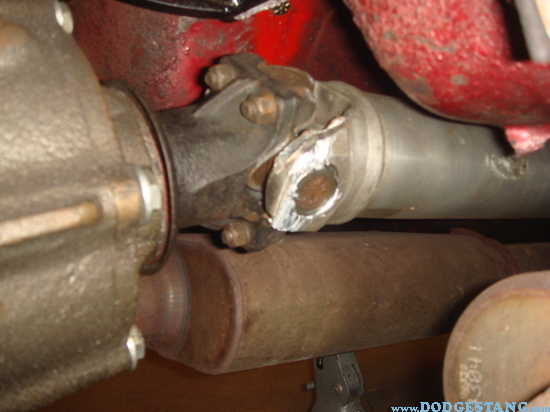

I know I have my war wounds
And I even upgrade all the stuff from the start....just not upgraded enough...a 410c can be a monster....but worth it
