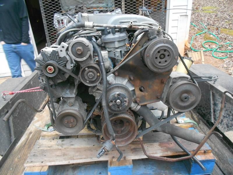

This was the engine and trasnmission the day I brought them home.

Originally Posted by cxr
did you document the swap? trying to talk my shade- tree-mechanic -carb -only brother in law to do this swap with the 289 block we have but he is resistant and i suck at automotive work.
btw: nice work
I took a TON of pictures as I went along.........I also did every bit of it myself, (except for wiring the ignition and mating it to the factory harness), so I'd be happy to answer any questions you might have. First things first.........I wouldn't convert that 289........I bought a complete EFI 5.0 and started from there. The only advantage I could see to the 289 is you wouldn't have to move the dipstick to the front (it's already there) and you wouldn't have to swap the oil pan and oil pickup. You also wouldn't have the roller cam setup....not that it couldn't be done of course!!! :-)
