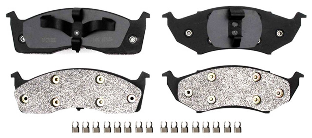

need to see a rear shot of the entire shoe.
do they look like these?
1979 granada

or these
Amazon Amazon

79 granada.
yours have plenty of meat left though.
